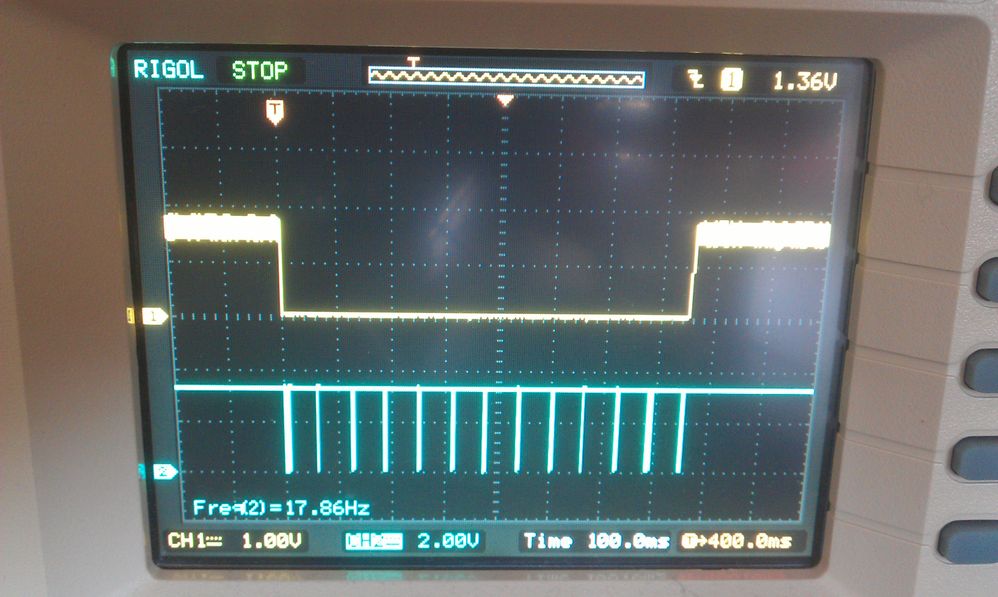

I had a look to the signals on the USBDM during the execution of the script. They look great, there is a clock signal on SWDCLK (about 2MHz) and some data on SWDIO.

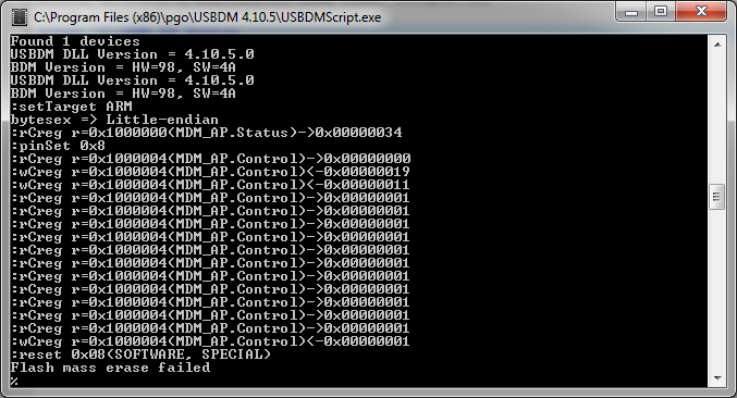

Joel69003
Hello PGO,
I looked at the datasheet, but I'm a little bit confused.
First of all, here is the result of the script: MDM AP Status = 0x34
Note that I had to add "catch { connect }" to your script, just after calling "Kinetis-KLxx-flash-scripts.tcl".
Ok, so, according now to the datasheet:
- Flash Mass Erase Acknowledge bit (0) is not set.
- Flash Ready bit (1) is not set. By reading the description, I'm not sure this is correct...
- System Security bit (2) is set . Again, not sure this is correct...
- System Reset bit (3) is not set, indicating that the system is in reset. Is it normal ?
- Reserved bit (4) is set.
- Mass Erase Enable bit (5) is set, so it seems that mass erase is enabled.
I don't know really how to interpret this. I have no Kinetis device to compare the result.

pgo
Senior Contributor V
Hi Guittet,
Thanks for the extra information.
I haven't really got much further with a reason for this.
The only thing I have noticed is that an entirely blank device suffers from continuous resets.  This would probably be due the watchdog timeout.
However the devices I have seem to mass erase OK.  Adding a capacitor to the reset signal would affect how long the device remains reset on power-on.
The only thing I can suggest is that it may be necessary to hold the reset low when powering on to make sure the device doesn't enter a bus fault situation before programming.
I will order some devices and see if I can find a consistent solution.
If you have access to an oscilloscope then you could check what the reset pin is doing on a blank device.
bye
PS.  I noticed that you indicated in your earlier post that you checked the signals on the SWD pins.  Did you check RESET?  You can use the following commands to check if you wish:
openbdm
settarget arm
pinSet rst=L # Reset should be low
pinSet rst=3 # Reset should be 3-state (pulled high)
pinSet rst=0
gs # Get target status while reset is low
11,781 Views
Joel69003
Hi PGO,
Yes I have a scope, I have recorded a trace looking at RST and BKGD signals and pressing "Detect chip" button in the ARM programmer.
This is done with the device I can't erase, so it fails. After power up and after the connection of the USBDM to the target, there is an oscillation of the RST signal (about 500Hz), probably because the device is continuously reseting.
I have tested your script and checked again the signals. I see the RST line going low, then the three state status (with the capacitor which is charging) and then it is low again.
I will now work with the chip I succeeded to erase and program, and I will keep the first one (maybe I will succeed to unlock the Security Bit later).
Thanks again for your help and your time,
Joel Guittet
