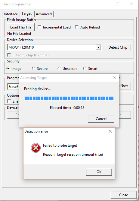

alicankurutepe
Hello Pgo
Thank you for reply.
Only difference between your schematic and mine, i connected to VBAT nothing (there is a battery holder but i did not mount the battery yet)
This time something different happened. usbdm couldnt detect chip also( with same error "Cannot read from target")
After some trials i got this message from "Detect Chip" this might be an useful tip

pgo
Senior Contributor V
Hi Alican,
I'm sorry I should have been more specific about what to do.
The error you are seeing now is due to the device being fully erased.  This will cause various problems with programming the device related to watchdog time-out and/or illegal instruction trap - both of which causes the chip to continuously reset. Hence the message about target reset pin timeout.
Could you try programming the chip again and select EraseMass.  This is the only reliable way of connecting to a target in the above state.
This will (probably) re-produce your original error.

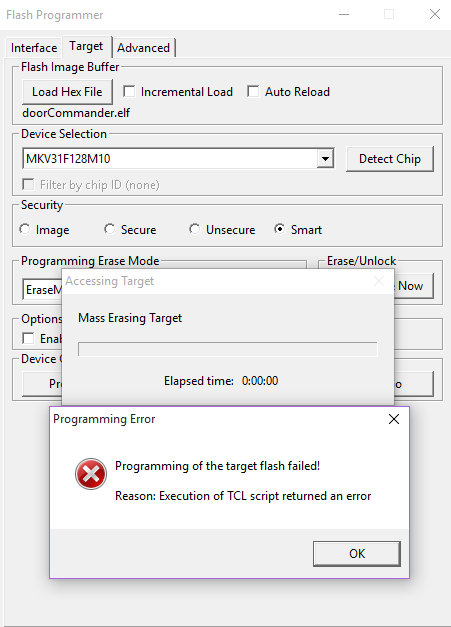

alicankurutepe
Hello Pgo
Thank you again.
This time i did not use Detect chip function as you said. unfortunetely it did not work.
i got another error this time.
i also tried some combinations in advanced tab bdm parameters. but i got nothing.
I attached my schematic file also in addition to log file that i may have been missing a point in schematic.
Please note that i bypassed SN74LVC and connected the reset pin of usbdm directly to  the net MCU_RESET_L.
Have a nice weekend.

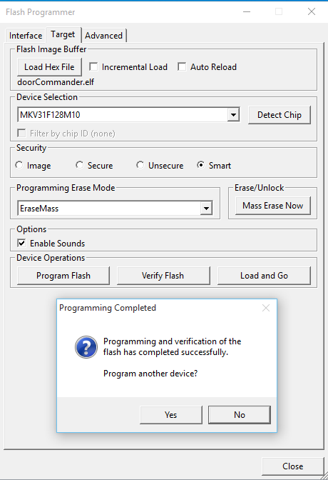

I have found an error in the device description used by USBDM for the  MKV31F128M10 but I am unsure if it would account for the errors you are seeing.
Could you use replace the file "C:\Program Files (x86)\pgo\USBDM ....\DeviceData\arm_devices.xml" with the attached file and see if it makes any difference?
You will probably need to select the EraseMass option,
4,651 Views
alicankurutepe
Hello pgo
Thank you for your efforts.
At least it seems working after replacing the xml file.
i did a few trials but it did not fail proframming with mass erase before programming.
i will also share anything notable while working on.
thanks again.
