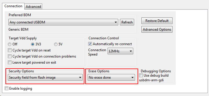

It is not stable that to use usbdm debug MK60DN512 in cw10.6. The error is in pic1.
but I can program it through arm programmer . in kds ,it alse can work.
bye

Hi Wang,
I tested with a TWR-K60N512 which I hope would be similar to the hardware you are using.
The flash project worked OK.
For RAM target you may need to make sure the options are set correctly to avoid it erasing the Flash and trying to program the security.  The flash should already contain a dummy program as well to avoid issues with resetting a blank device.
Let me know if this doesn't help.

wangbaode
Hi pgo,
Thanks for your reply. According to your suggest, It works well .
