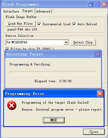

I meet a question when I program MC9S08PA4.
I can detect the chip and erase the chip through USBDM.but the chip can't be programmed through USBDM.
My USBDM firmware is 4.10.5.USBDM hardware is USBDM_SWD_SER_JS16CWJ_V2.0.
could you try it ?

Hi Wang,
The PA4 and PA2 are not supported by USDBM at the moment due to the limited amount of RAM available in combination with the new Flash technology.
I will have to re-write the drivers to do this.  I had a look at this last week end but it is quite difficult so I'm unsure when they will be supported.

Hi Wang,
USBDM_4_10_6_60.Win.msi, just uploaded to sourceforge, adds support for MC9S08PA4 and MC9S08PA2.
