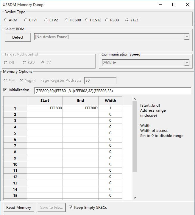

Wuzhong
My chip is S9S12ZVL16F0MLC and why to writ and read data form FFE800~FFE80D?80D.JPG
is it right?
Boone

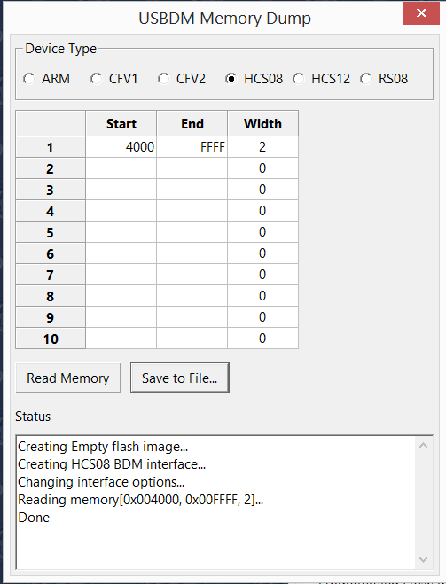

chris02
Hi pgo,
I'm glad that you found the bug.
Today I tried again to flash/erase and I didn't get a secure error. Mass erasing is working now, somtimes (so I guess you are right with watchdog problem).
But if I try to flash a dump (made with your memory dumper) I get another error: "Program data not within target Flash Memory". For settings see my attached screenshot.
Thanks so much and best regards
Chris

pgo
Senior Contributor V
Hi Chris,
The error means that the programmer has detected data that doesn't lie with valid Flash memory.
This may mean that you are saving an incorrect range of memory or I have incorrectly specified the memory range for the AW48 in the USBDM configuration file  hcs08_devices.xml.
Can you post information about the range you are saving so that I can check please?
If it is not confidential you could also post the image file so I can check if there is a bug in the memory dump program.
bye
PS. The range assumed in hcs08_devices.xml  is: 0x4000...0xFFFF based on the memory map in the AW48 manual (p40).
