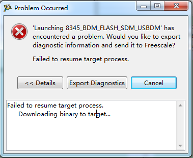

Failed to resume target process. Downloading binary to target...

Hi all, and particularly PGO,
I'm experimenting issues with CodeWarrior10.6 and the USBDM with DSC MC56F8345 or MC56F84789 device. I have created a project and keep all default options. However, it is not possible to load and debug the application. I get the following error when launching the debugging:
In the console:
Executing Initialization File: E:\Codewarrior\84789_BDM/Project_Settings/Debugger/MC56F84789.tcl
radix x
cmdwin::eclipse::config hexprefix 0x
cmdwin::eclipse::config MemWidth 16
cmdwin::eclipse::config MemAccess 16
cmdwin::eclipse::config MemSwap off
Starting 3rd party flash programming...
DiMemoryDownload() - DI_DNLD_TERMINATE - Programming memory image...
Programming target
  Device = 'MC56F84585'
  Trim, F=0, NVA@0000, clock@0000
  Ram[0000...3FFF]
  Erase=EraseMass
  Security=intelligent
  Total bytes=35556
  doRamWrites=T
Erase Time = 3.48 s, Speed = 9.97 kBytes/s, rc = 0
DiMemoryDownload() - DI_DNLD_TERMINATE - Programming complete, rc = 7

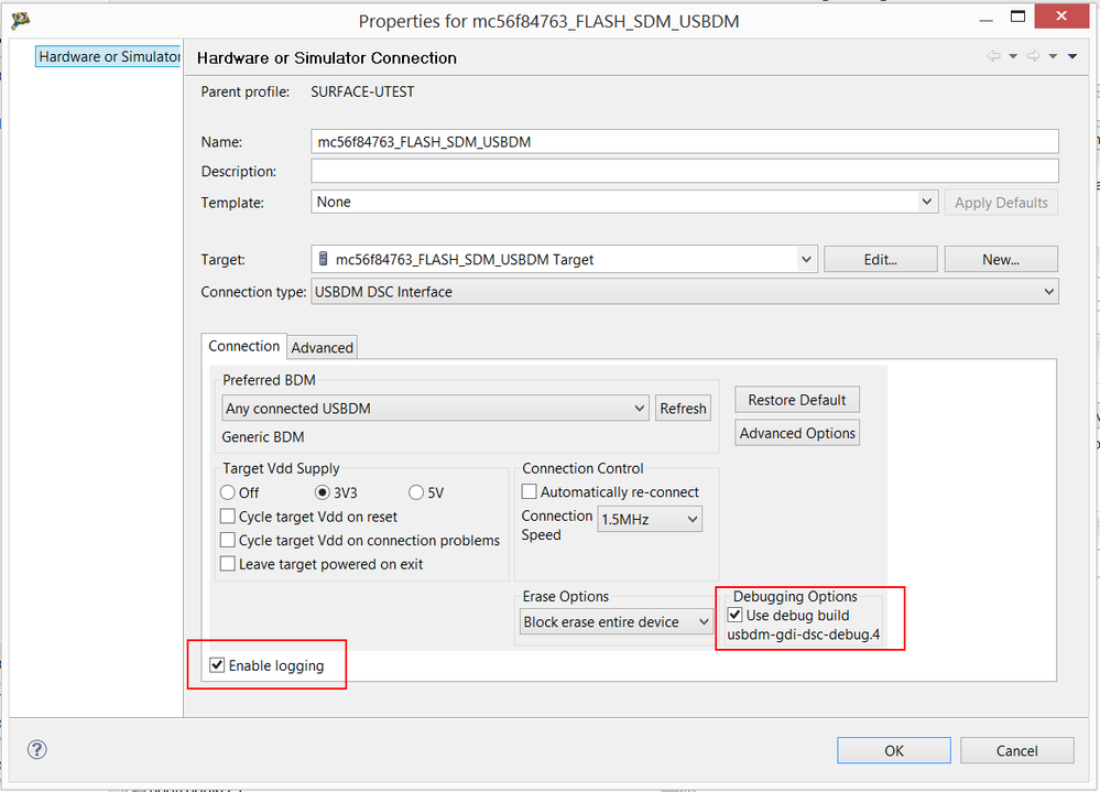

Hi yongsheng,
Could you change the options in Codewarrior to use the debug build of  the GDI interface:
This will produce a more verbose log in the Codewarrior Console as well as separate USBDM log files
Please look in %APPADATA%/usbdm for the usbdm.log and another DSC or MC56F log file and post here.
bye

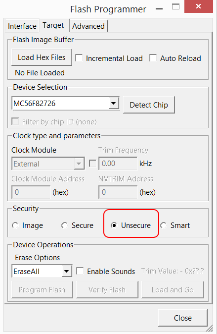

Hi yongsheng,
The GDI_DSC.log file is indicating that it is finding the device secured.
This may be due to a detection problem in the software but could you do the following to check please:
  • Use the stand-alone programmer to program the same file that you are using in the project.
  • Make sure you select Unsecure option:
  • Verify the Flash.
  • Try again with Codewarrior and see if it makes any difference.
You can also change the erase option in Codewarrior to "Mass Erase". to see if it makes any difference.
bye
