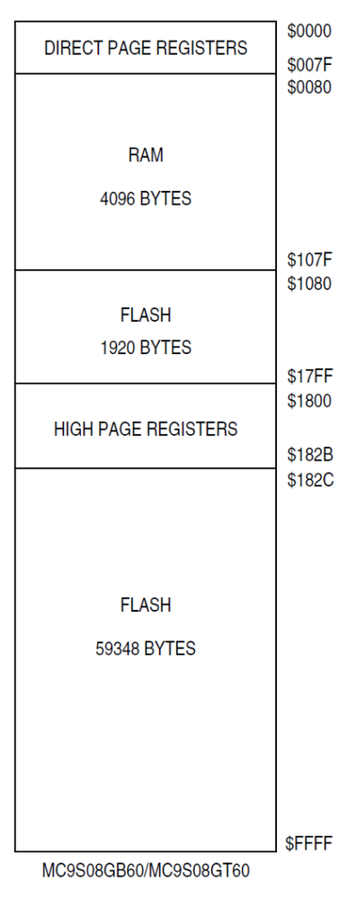

Hi. I'm trying to read the memory of a MC9S08GB60 processor with the USBDM programmer and the memory dump application, but I have some doubts about the parameters to use.
I used the following parameters:
Device Type: HCS08
Communication Speed: 250kHZ
Address range: Start: C000 - End: FFFF - Width: 1
They are correct, or there is a risk of losing some information?
Thanks in advance (and sorry for my english! :smileyhappy: )
Best Regards
2,031 Views
pgo
Senior Contributor V
Hi Khryme,
Please check the memory map in the GB60 Manual:
You would need the two flash ranges as shown above:
1080 - 17FF, size 1
182C - FFFF, size 1
If you leave the "Keep Empty SRECs" unchecked then unprogrammed areas will be omitted from the image file.
