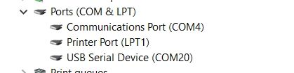

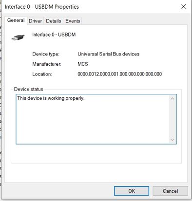

After your advice, I checked the  Device Manager in windows, and this is what it shows. Seems to be OK. Along many installations of USBDM in Windows, I have seen many "flavors" of the way USBDM is shown in the Device Manager window. I can't really tell why this happens and which of the different shown formats is the right one. Anyway everything seems to work fine.
01-Device Manager.jpg01-Device Manager.jpg02-Device Manager.jpg02-Device Manager.jpg

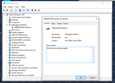

I forgot - The device will appear twice:
  1. Once as serial device supporting communication with the target (the image you posted shows this.)
  2. It should also appear as a Debugging Interface as shown in my post.
The second of these is the important one for debugging.
bye
16,146 Views
BooleanBob
Dear PGO, sorry for the delay but the community not always sends an email when replies arrive in.
"I forgot - The device will appear twice:
The second of these is the important one for debugging."
The second.... well ... it doesn't.
Instead, it appears as a COM port (COM20 in this case as the picture shows)
But this is a veeeery old issue. I have sometimes used the Zadig solution, but I know that you don't like it and I just didn't give it a chance because we are in a process of clean testing. This driver has a sticky frequent USB numerator issue.
Do you want me to try with Zadig "brute force" method?
Anyway, debugging KA2 with CW 11.1 would first require a good programming, but I don't know if this USB installation driver problem could be the cause of bad RS08 programming. This could explain many things. But I can perfectly program and debug S08.
