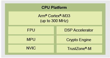

The RT600 General Purpose CPU Platform
The CPU platform in the RT600 is based upon the Arm® Cortex®-M33 core (CM33).    By itself, the CM33 is capable of sophisticated audio applications. The CM33 is built on the Armv8-M architecture which includes Single Instruction on Multiple Data (SIMD) as well as Multiply And Accumulate (MAC) instructions.    There is quite a bit that could be accomplished with CM33 running at 300MHz before evening considering the additional DSP core.    Last year I wrote quite a bit about the LPC5500 series MCUs focusing on the LPC55S69 and its ample processing capabilities.     The LPC55S69 is also based upon the CM33 core (running at 150MHz vs 300MHz).       I think of the RT600 as a serious upgrade to the LPC55 when you need more of everything.
 Figure 2.  The RT600 General Purpose CPU Platform.

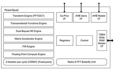

One feature of the CM33 is a co-processor interface which can be accessed with special assembly language instructions. There are two “co-processors” attached to the CM33 in the RT600:  The PowerQuad (labeled as the DSP Accelerator) and the CASPER (labeled as the Crypto Engine).
The PowerQuad Co-Processor
The PowerQuad is a dedicated hardware unit that runs in parallel to the CM33 core inside the RT600.  By using the PowerQuad to work in parallel to the CM33, it is possible to implement sophisticated signal processing algorithms while leaving your general purpose CM33 core available to do other tasks such as communication and IO.
Figure 3.  The RT600 PowerQuad Co-Processor.
For the LPC55S69 release, I wrote four articles on the PowerQuad and detailed some of its use cases:
The key takeaway here is that before we have even considered the additional DSP core, the RT600 offers a powerful hardware co-processor that can do very useful operations “out of the box”.     We can be crunching Fast Fourier Transforms (FFTs) at a high rate before even tapping into any of the resources of the DSP or CM33 cores!

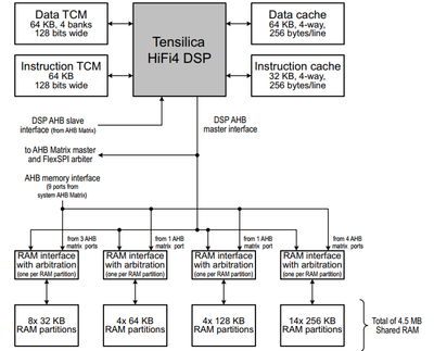

The availability of 4.5MB of internal SRAM immediately should catch your attention!     I tend to think in terms of real-time audio applications for musical performance.   4.5MB of RAM allows for deep buffers to implement delay-based effects include loopers and large time constant reverbs.      A 4.5MB pool of fast SRAM removes the need for slower external SDRAM (which is common in many audio DSP architectures).      The 4.5MB is shared between the CM33 and the HiFi4 DSP.    The memory is sufficiently partitioned to allow for a large amount of flexibility in the processing architecture.    There are 30 partitions across 9 AHB ports.  This means the processing system can be designed to minimize contention between the CPUs and RAM allowing for maximum throughput.
The HiFi4 DSP has dedicated local Tightly Coupled Memories (TCMs) for data and code.  Each TCM is 64 KB accessed by a 128-bit port.  The code and data TCMs can be accessed by the Cortex-M33 and by the DMA controllers through a slave port on the AHB matrix.  These connections allow the CM33 to bootstrap the HiFi4 with executable code.   In addition to the TCMs, there is a has a dedicated 4-way data cache of 64 KB with 256 bytes per line and a dedicated 4-way instruction cache of 32 KB with 256 bytes per line.      The local HiFi4 memory architecture enables the highest level of processing capability as the DSP engine can access code and data with minimal bottle neck.
Figure 7.  HiFi4 Local Memory Architecture.
