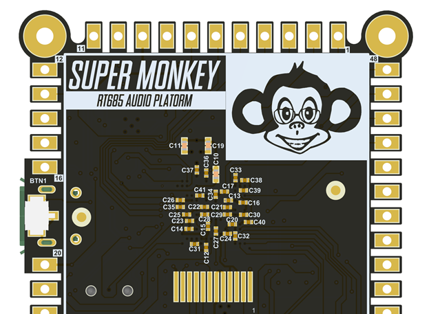

 Figure 2.  0201 Decoupling Capacitors
I usually try to use packages that are as large as possible to ease manufacturing but in this case I elected to use an 0201 size capacitor to experiment with the “perfect 0201” land pattern provided by Chris Denny of Worthington Assembly.  I believe with some work, 0402 size capacitors could be used with the RT685 to relax manufacturing tolerance.   On my next project with the RT685, I may use a smaller number of 0402 0.22uF decoupling caps in place of 0201 sized 0.1uF decoupling caps.

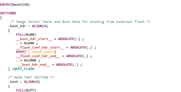

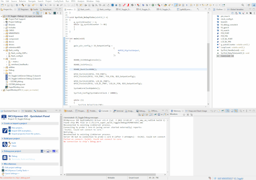

The RT685 Boot Header

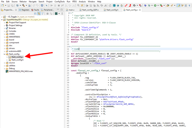

From the build tooling perspective, there are a couple changes that are necessary to use QSPI flash with the RT685.     You can use an MCUXpresso SDK example project as a starting point even though it is configured to use octal flash.   The RT685 ROM bootloader will attempt to access an external device on FlexSPI A or B (depending on the ISP[2:0] pins) using a 1-bit IO mode.     A special data structure, the boot header, is to be located at a 0x400 byte offset from the start of external flash.  This boot header provides additional configuration details to the bootloader about the attached flash device.   All the example RT685 projects in the MCUXPresso SDK have a boot header for suitable for an octal flash device.  You can find the boot header in flash_config/flash_config.c and it will need to be modified to support QSPI boot.
 Figure 5.  Boot Header Location In Source
If you dig into the linker file generated by the build tools,   it specifies a special section that is placed in the QSPI memory region.   Note that the .ld linker files are automatically generated by default by MCUXpresso and placed in the build configuration output folder (for example, “debug”).
 Figure 6.  Boot Header Placement with the Linker
Here is an example of a functional QSPI boot header:

Once the boot header is built into your image, the RT685 becomes “stand-alone” after a power cycle.    Note that if your project does not have a boot header, or if it is not valid, the ROM bootloader will jump to USB/serial downloader mode.      There are tools, such as
https://github.com/JayHeng/NXP-MCUBootFlasher
that can also generate a boot header as well as place it in the proper location in flash.  I personally like to bake it into the C source code so the project is “bootable” without any additional steps.

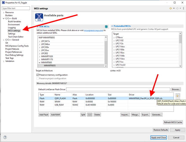

MCUXpresso + MCU-Link
MCUXpresso is capable of programming QSPI flash on the RT685 with the low-cost MCU-Link debug adapter.    This is a path for quick success but requires a change to the MCUXpresso project to indicate the type of flash connected and the FlexSPI port.
 Figure 7.  QSPI Flash Programming Driver in MCUXpresso
Ensure that  “MIMXRT600_FlexSPI_A_SFDP_QSPI.cfx” is selected as the “Driver” for the flash region.    Once this change is made,  you can simply start a debug session and MCUXpresso will be able to program a QSPI flash connected to FlexSPI port A.

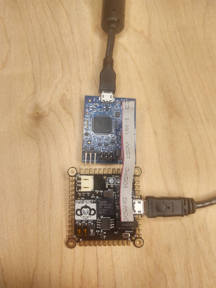

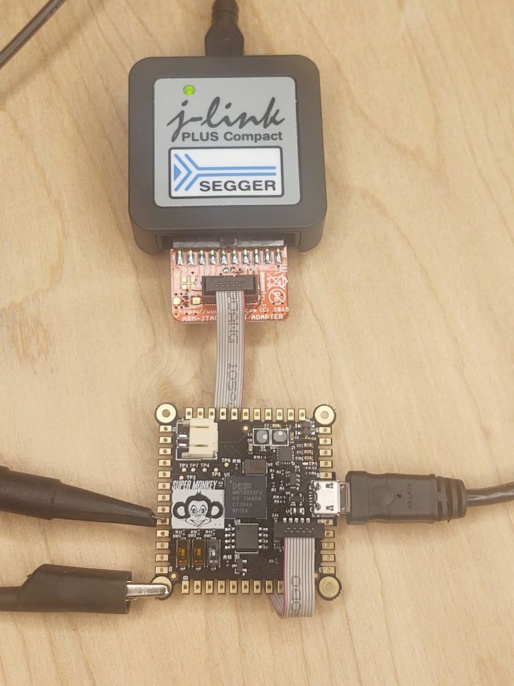

 Figure 8.  Programming and Debug with an NXP MCU-Link Probe
Segger J-Link + Segger Ozone

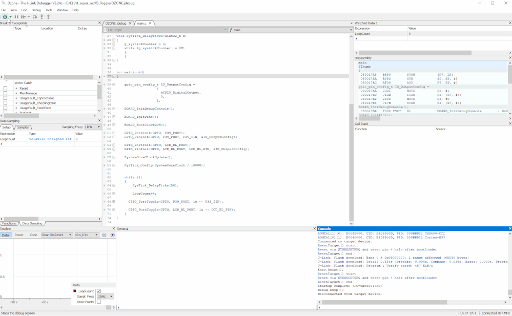

A tool that has become a favorite in my arsenal is Segger’s Ozone Debugger.    It is a full featured source level graphically debugger designed to work with a Segger J-Link.  All you have to do is point to your .elf or .axf file and Ozone handles the rest.  I have found Ozone to be a great option as it is very fast,  can inspect variables without halting the MCU and works with all of NXP’s ARM MCUs.   I discovered it back in 2014 were I needed a better way of performing dual core debugging on the NXP LPC4357 and have been using it ever since.
When setting up an Ozone project, there are a couple of setting that are required for working with the i.MX RT685.  Per Segger’s Wiki Article for the RT600, use the MIMXRT685SFAWBR device when your flash device is on FlexSPI port A.
 Figure 9.  Segger i.MX RT685 QSPI on FlexSPI Port A Setup

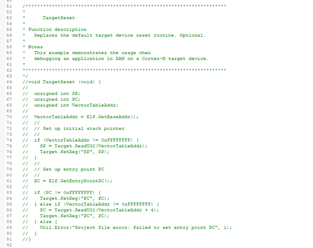

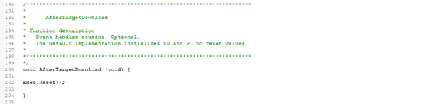

Also per Segger’s Wiki Article working on with a bootloader,   make sure to uncomment  AfterTargetDownload() and AfterTargetReset().
I leave the Exec.Reset() to make sure to reset the CPU after programming so the ROM bootloader can take over.  Lastly, make sure TargetReset() is left commented outEli_H_2-1635812754592.png

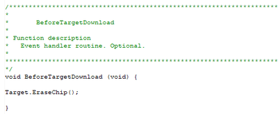

I did find that the built in programming algorithm the J-Link seems to not erase used/dirty sectors.     I added a "full target erase" command to fix the issue.
**Note**   The need for "Target.EraseChip"  was fixed as of J-Link Software version V7.65A.   See Here:
https://community.nxp.com/t5/i-MX-RT/i-MX-RT685-QSPI-Port-A-Segger-Flash-Programming-Fix/m-p/1440741...
An alternate programming algorithm was suggest here:
https://community.nxp.com/t5/i-MX-RT-Knowledge-Base/RT600-MCUXpresso-JLINK-debug-QSPI-flash/ta-p/134...
These steps are important so that the ROM bootloader functions in i.MXRT685 are not interfered with after the flash is programmed and the target is reset. Once we have a working boot header and the ability to program the board, the first order of business is to toggle an IO pin.  My first test program toggled a couple IO every 50mS.
 Figure 10 .  Programming and Debug with a Segger J-Link and Segger Ozone.

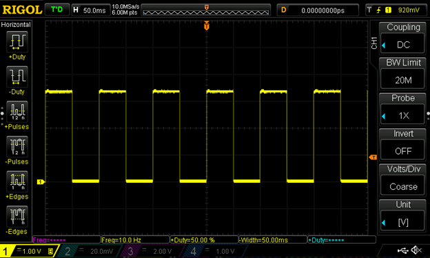

At this point, we have successfully brought up the RT685 with QSPI on FlexSPI port A and successfully have toggled an IO.  From here I can start working on IO interfaces, increase clock rates to the various subsystems, etc.   I hope this article series has been helpful in introducing the i.MX RT685 and showing a simple configuration.       In case you missed them, here are links to previous content on the i.MX RT685.    I hope you find the information helpful and are successful with your own i.MX RT600 based project.
