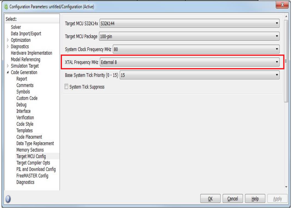

How to select XTAL frequency in S32K model based design toolbox other than 8MHz or 40MHz? There are only two selections 8MHz and 40MHz.

Hi hemantsindkar‌,
In model based design - we have the selection only for the option that exist on NXP development boards. Right now you can't select other frequencies since there is no way for us to tested. We will have a new release in October 2017 and we are considering your input in this matter.
I've logged this as: AST-708
Thank you!
