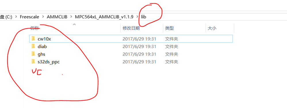

Where can i get the the lib of the AMMCLIB_v1.1.9?,i wanna transplant the AMMCLIB_v1.1.9 files to the VC sofware

Hi dumitru-daniel.popa,
     Where can i get the the lib of  the AMMCLIB_v1.1.9?,i wanna transplant the AMMCLIB_v1.1.9 files to the VC sofware,i wanna use the VS2010 to test the function in  AMMCLIB,such as the cos,sin ,or CLARK,,,,,,
but the lib there is not the *.lib file,can you send me the file?

Hi edenli‌,
There is an issue logged by me as consequence of interaction via Community with another user that is requesting such support to petrfajmon-b17364‌ 's AMMCLIB team. The issue is logged as: MCL-440
Unfortuatly i do not have the library 1.1.9 available for VC - but i can offer you the 1.1.8 version instead (it should be ok for what you need).
Please see this topic - https://community.nxp.com/message/922831#comment-925678 and download the CustomCodeAMMCLIB.zip
Inside the zip you will find the library compiled with VisualStudio.
Hope this helps!

Hi daniel,
when i try link to the MCL-440,but the result tip  i can find web,and i use the AMMCLIB files to my other chip project,but shown as below:
it seems that the AMMCLIB.lib ,has some question?how can i solve it ?

Hi edenli‌,
That MCL-440 is the ID of the feature request i logged for this matter and it should be used just as a reference. Unfortunately external customers does not have yet access to NXP's internal tracking database that is why the link is not working.
In respect with the second aspect - i'm afraid i can't understand what you have done.
So you downloaded the AMMCLIB.lib from the zip i've suggested and you tried to link that with your project and compile it S32DS ?
If that is the case, then it will not work. That library can only be used with x86 compiler. The library was compiled to work in Windows environment.
