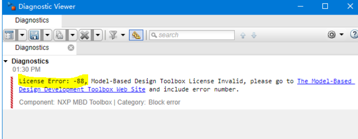

I have purchased the product "Model-Based Design Toolbox for S32K1xx Automotive Microprocessors Family "for work. Unfortunately, after dozens of attempts the license does not work.
I have read the Licensing Guide, and follow the guide step by step. My operational steps can be found in the attachment.
Our job is forced to suspend because of the license, please help me to find the reason.
Thank you so much, and  I am anticipating your reply.

NXP Model-Based Design Toolbox is using FlexNet licensing mechanisms. According to your screenshots (by the way, you did a very good job reporting the issue back), I see the FlexNet reports: Error -88
Error -88 means: License Management | FlexNet licensing error -88 - The system clock has been set back – Arm Develope...

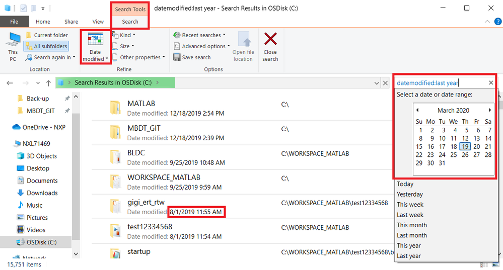

Therefore, at some time your computer data&time have been changed accidentally or intentionally. During that time the operating system has created some files with that particular timestamp. To fix the licensing issue, you need to search for those files and delete them.
One easy way is to search with Windows Explorer:
Hope this will help you find the culprit and eliminate it.
