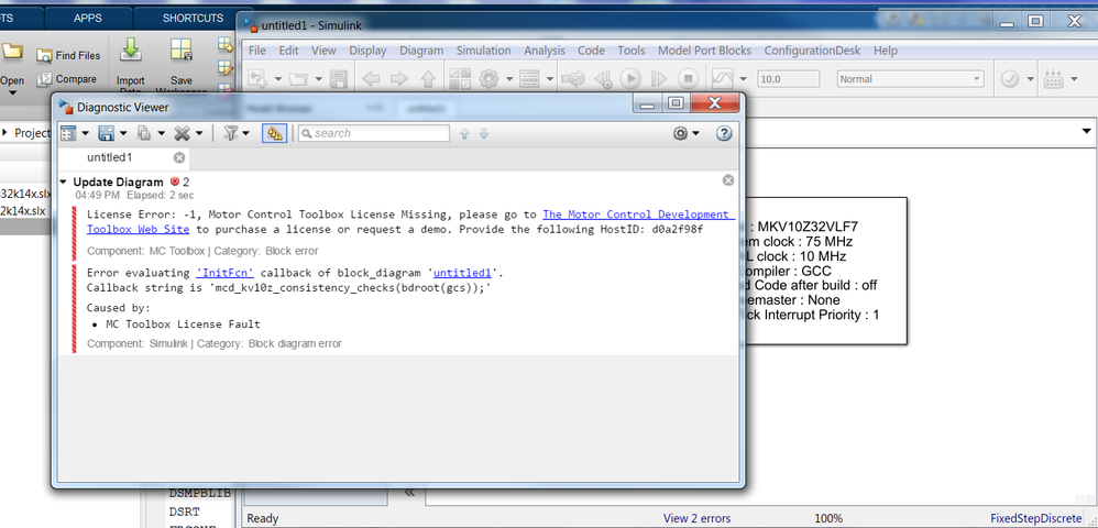

m_benderradji
Marius,
Now i have another issue with the motor control toolbox for Kinetis. Refer to the following:
Could you please help me to resolve this issue. Thanks in advance
1,909 Views
mariuslucianand
Hello m.benderradji@outlook.fr‌,
For the License Error issue, you need to get a license file (which is free) from the NXP website. You will find it on the same page from where you downloaded the toolbox.
From the second question regarding the error it seems to be a compiler error. If I am not wrong you asked me about how to change the compiler. Please remove or rename the Path name an check if it works with the default one.

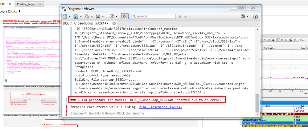

m_benderradji
Marius,
I have only 2 toolboxes: MBDT for S32K MCU 2018.R1 and the one for Kinetis
For the seconde issue please find blow the hole log:
Build 4 2 1 Clear

### Build procedure for model: 'BLDC_ClosedLoop_s32k14x' aborted due to an error.
Error(s) encountered while building "BLDC_ClosedLoop_s32k14x"

I have a second issue when i try to build the "BLDC_ClosedLoop_s32k14x.slx" exemple of NXP MBDT 2018.R1 for S32K MCU's . Refer to the following:
Is this issue relevant to the first one ?
Thanks in advance for your support
1,909 Views
mariuslucianand
Firstly, let's clarify some things. In this response you mentioned 3 different toolboxes. The one for Kinetis, MPC574xP and MBDT for S32K MCU 2018.R1. The slsfnagctlr.p fix it is only applicable to the Kinetis and MPC574xP toolboxes which were not tested on the 2017b Matlab's version because were released before 2017 and the Matlab' API has changed.
Please excuse me but probably I din't provided the right fix link for Kinetis. Please follow the next thread HotFix: MBD Toolbox for Kinetis.
For MPC574x the file structure should be smth like this {Toolbox install dir}\mbdtbx_pnt\mbdtbx_pnt\mscripts. Do not create folders, just try finding the ones specified.
every toolbox has a file that adds all the required files in Matlab's path. For Mpc574xP it is called mbd_pnt_path.m. If you use the MPC574xP please run that.
Now, the problem you are facing is a compiler problem, and apparently you are trying to run an example on BLDC motor for S32K144 board and it is not relevant to the one related with slsfnagctlr.p. Please consider sending me the hole log because I can not figure it out just by the last lines.
