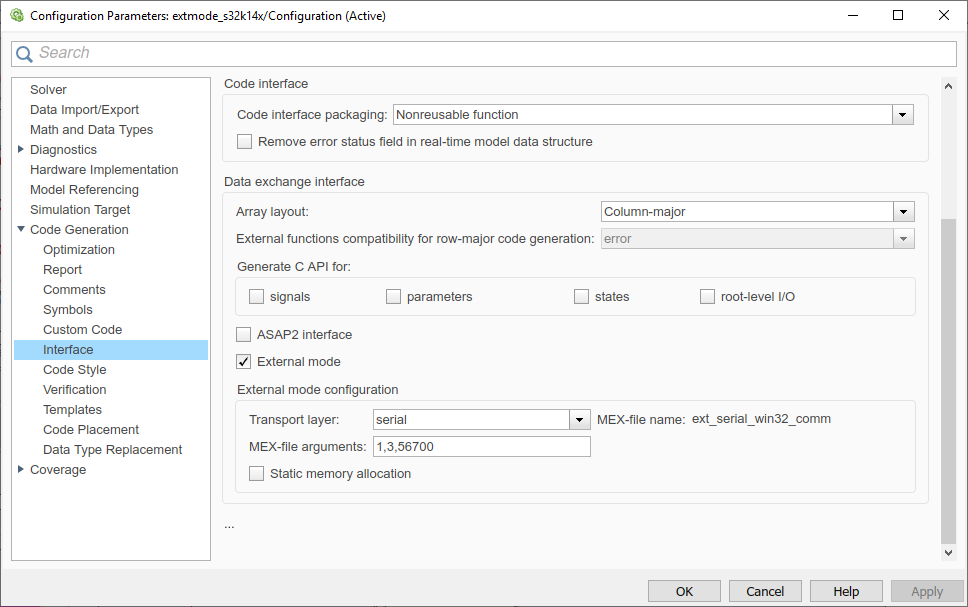

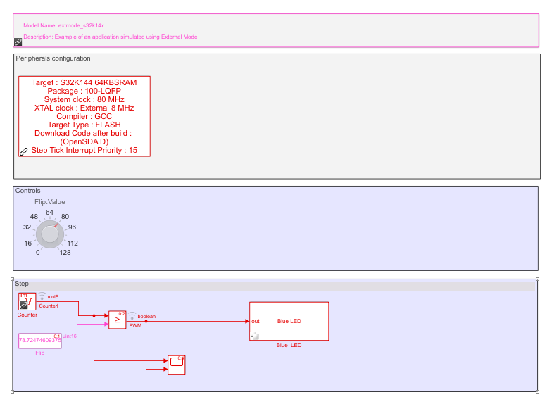

I'm trying to get the MBDT example for External Mode to work with a S32K144EVB. However, the example fails to compile when External Mode is enabled in config.
Model:
Settings used for External Mode (COM3 port, 56700 baud rate):

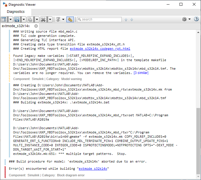

The error encountered during build:

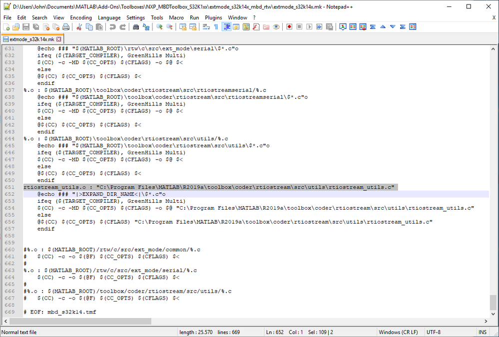

Corresponding line in the makefile, I believe:

The error is caused by how Matlab generates the makefile to build the application in R2019a release. On line 651 in extmode_s32k14x.tmf it creates a rule with spaces in the prerequisites part, "C:\Programs Files\MATLAB\R2019a\...". That rule is generated automatically by Matlab to build a required Matlab C source file rtiostream_utils.c.
I am still investigating why Matlab generates this strange rules in R2019a.
For now, as a workaround you can move Matlab to C:\MATLAB\R2019a or some other path without spaces.

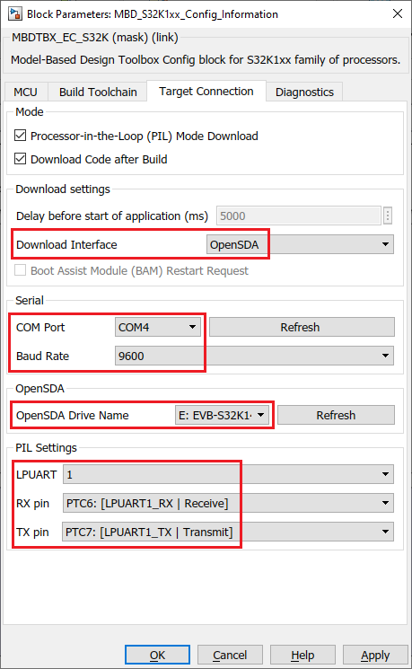

Note the Target Connection configuration needs to be set properly for the code to be deployed and run successfully:
There is one remaining challenge, however, given the knob on the dashboard has no effect on the duty cycle of the flashing LED, and the scope does not show any activity from the board; it is as if the application runs on the board without any persistent connection to Simulink, as one would expect from External Mode.  It is if the example is not running in External Mode. But I cannot see any options or settings to turn it on.
Any suggestions for overcoming this last challenge are welcome.
