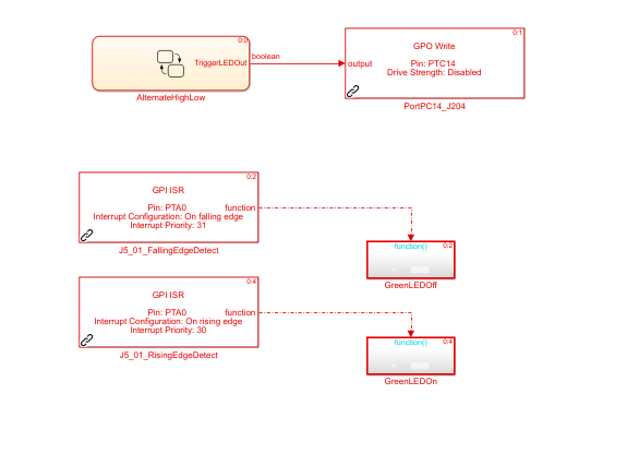

I am using DEVKIT-MPC5744P Board (REV-E).
I am using a GPO to toggle a pin and using the same ping to provide input to another GPI
I am trying to use Rising Edge Detection and Falling Edge Detection using different GPI ISR blocks. (shown below)
To test i use an LED. for falling edge it shall be off and for rising edge it shall be on. But the LED stays on. Somehow both ISR for same pin is not working in this toolbox. Please provide your input.

So you can only get 1 ISR block for 1 pin - but you can set it to trigger on both edges, and check inside the ISR the pin value. You can either use the input block to get the value and pass it to an IF block - one branch being the "Turn ON" subsystem, while the other branch being the "Turn OFF" subsystem. One more thing I'd like to mention is that we also have register read/write block - you can use those for fine grain control. For instance, here you can use it to get the PDIR register value (which if I remember correctly is the Port Data Input Register in which you find the values for the pins):
So to sum it up - 1 ISR block for the pin you want, using both edges as a trigger and inside the ISR subsystem you'll want to get the pin value to decide which subsystem to execute.

The option where we use GPI block and split using if else does not work somehow.
The Either Edge ISR works but somehow if else arbitration does not work. The LED does not blink at all

Can you also attach a zip with the generated code? I want to check something in the code generated at your end - there is a known bug in mathworks' code generation (for this exact scenario, with 2 subsystems called on different if branches, having inside the same blocks called - in your case both subsystems have 1 constant block and 1 GPO block). I just want to make sure that's not the problem in your case (although I suspect it is).

We have the following problem: when using the GPI ISR block and the GPI block, initialization code for only one of those is ran - we verify so that we do not initialize the same pin twice. So when you add the GPI block inside the subsystem, the ISR is no longer ran (due to lack of initialization for it). That is what is failing in your model. I will tackle this issue and come back with a fix. I will post it here so stay tuned.

We found a temporary solution (for time bing) using the registers as shown below (model attached)
The value for the pad can be read here and we can know is it's rising or falling.
