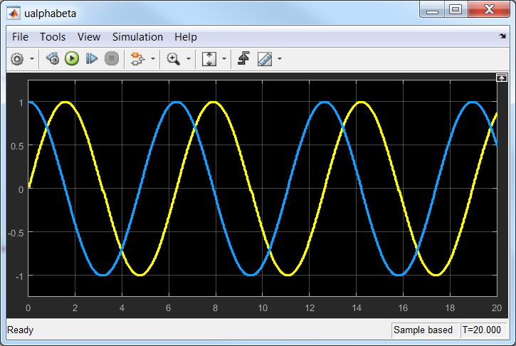

Output of the SVM is not saturated only if the input to is a [-1,1] sin/cos inputs
The inputs to the Space Vector Modulation block represents the 3-phase stator voltages Ua, Ub, Uc that are transformed via the Inverse Clarke Transformation into Ualpha, Ubeta 2-phase orthogonal coordinate system.
In general in embedded system - and in particular in motor control application - all the variables are scaled relatively to maximum values supported by the system sensors. In case of voltages, the shunts/opams/adc chains are design to support a maximum read out. Therefore all the quantities derived or that relates with the voltage are scaled to the [-1, 1] interval by max Vdc supported value.

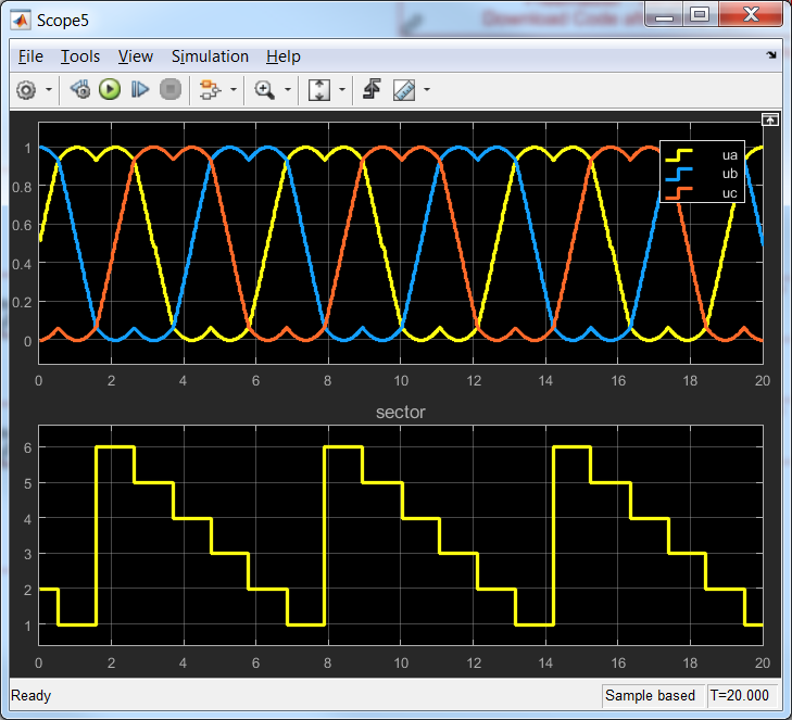

Using Ualpha and Ubeta, the stator voltage vector Us is constructed with the appropriate combination of inverter switching patterns. Based on the actual value needed for the stator voltage vector Us to control the rotor position, the 6 inverter switches must be controlled: ON or OFF for an amount of time - duty cycle/factor.
So, the output of the SVM block represents the PWM duty cycle to control the inverter switches/transistors. Since the duty cycle represent the relative time of the transitor to be ON/OFF the only meaningful values are between [0 and 1]
And finally:
... the output of the SVM, should it be exactly changing from 0 to 1 in order to have proper operation of the power stage ? or it could be changing between any [min, max] values inside [0,1]!
Yes, it should always be between [0=OFF ... 1=ON] interval since it is a PWM duty cycle value. Note that SVM also implement the 3rd harmonic injection to increase the actual phase voltage from Vdc/2 -> 0.155* Vdc/2 (see the curly waveform) - but that is a different topic.
