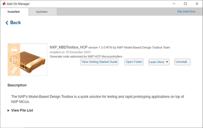

The Automotive Processing, Model-Based Design Tools Team at NXP Semiconductors, is pleased to announce the release of the Model-Based Design Toolbox for HCP version 1.3.0. This release supports automatic code generation from MATLAB/Simulink for S32G2xx, S32R41x, and S32S2xx MCUs. This new product adds support S32R41 Cut 1.1 and S32G3, C++ code generation for S32G2 and S32G3,  Radar examples for S32R41, and support for MATLAB versions R2021a - R2023b for running in Software-in-the-Loop and Processor-in-the-Loop modes.

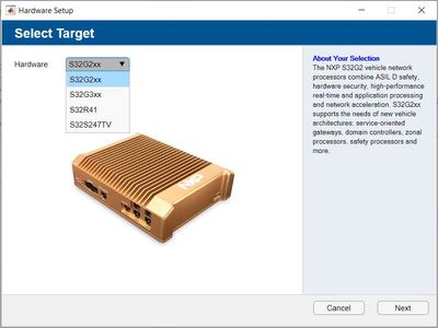

  • Supported Evaluation Boards
    • GoldBox 2 Development Platform (S32G-VNP-RDB2 Reference Design Board)
    • GoldBox 3 Development Platform (S32G-VNP-RDB3 Reference Design Board)
    • X-S32R41-EVB Development Board
    • GreenBox 2 Development Platform

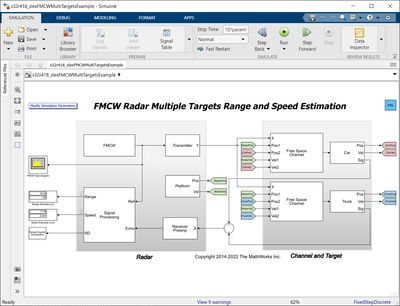

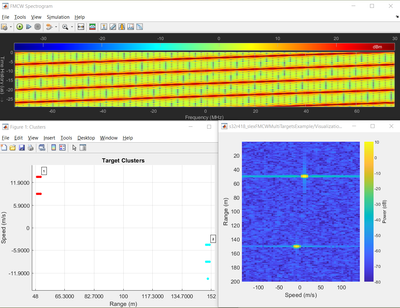

    • MathWorks Automotive Adaptive Cruise Control Using FMCW and MFSK Technology examples ported to S32R41:
      • MSFK Radar Range and Speed Estimation of Multiple Targets
      • FMCW Radar Multiple Targets Range and Speed Estimation
  • GUI to help you setup the toolbox and the evaluation board:
