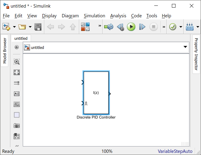

Have you tried to use the standard Simulink Discrete PID Controller ?
That block can be configured exactly as you have suggested - integrator with reset option.
To achieve this you have to:

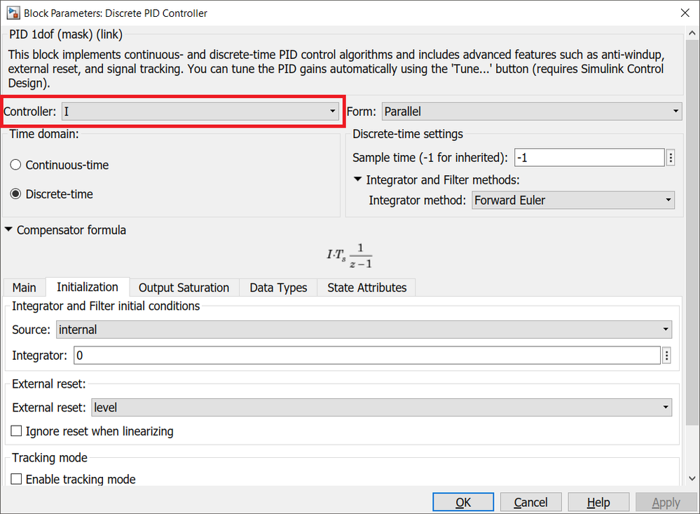

1. select the Controller type as: I
2. select the appropriate integrator method

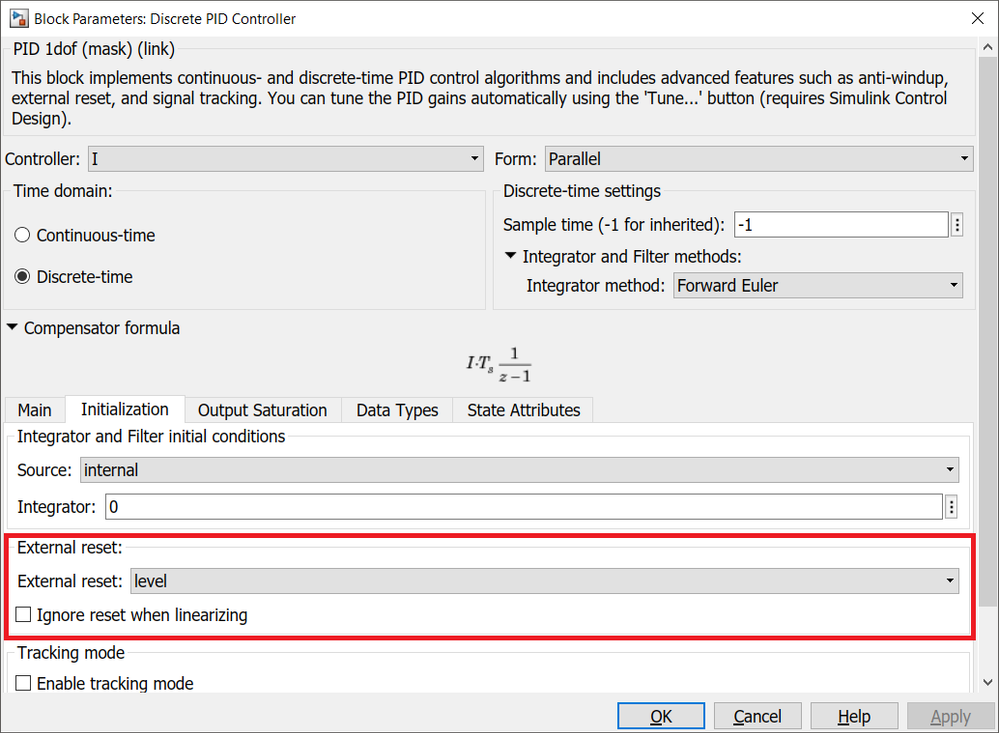

3. enable the External reset option
Can you check on your side if this approach will address your use-case. If not, then we can add a feature request to add the capability on the AMMCLIB block to do this as well.
