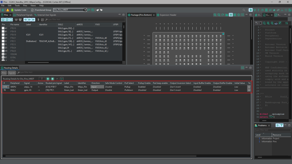

Pins configuration
Two pins must be configured for this application:
  • Signal wkpu,14  (of WKPU peripheral) to the PTB17.
    • Direction: Input
    • Pull Select: Pullup
    • Pullup Enable: Enabled
  • Signal gpio, 65 (of SIUL2 peripheral) to the PTC1.
    • Direction: Output
Figure 1. Configuration Pins tab - Dio_Pins_MBDT Functional Group

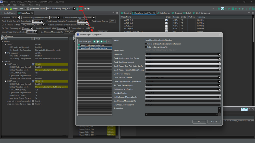

Clocks configuration
A new Functional Group must be created for the Standby Mode. This can be done from the Clocks tab (as shown in the image below).
Figure 2. Configuration Clock tab - Create new Functional Group

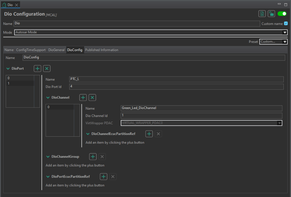

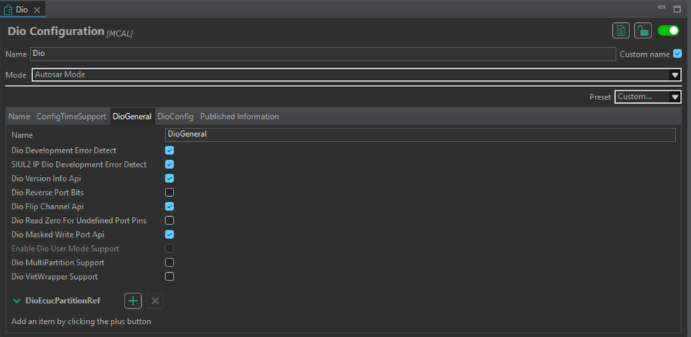

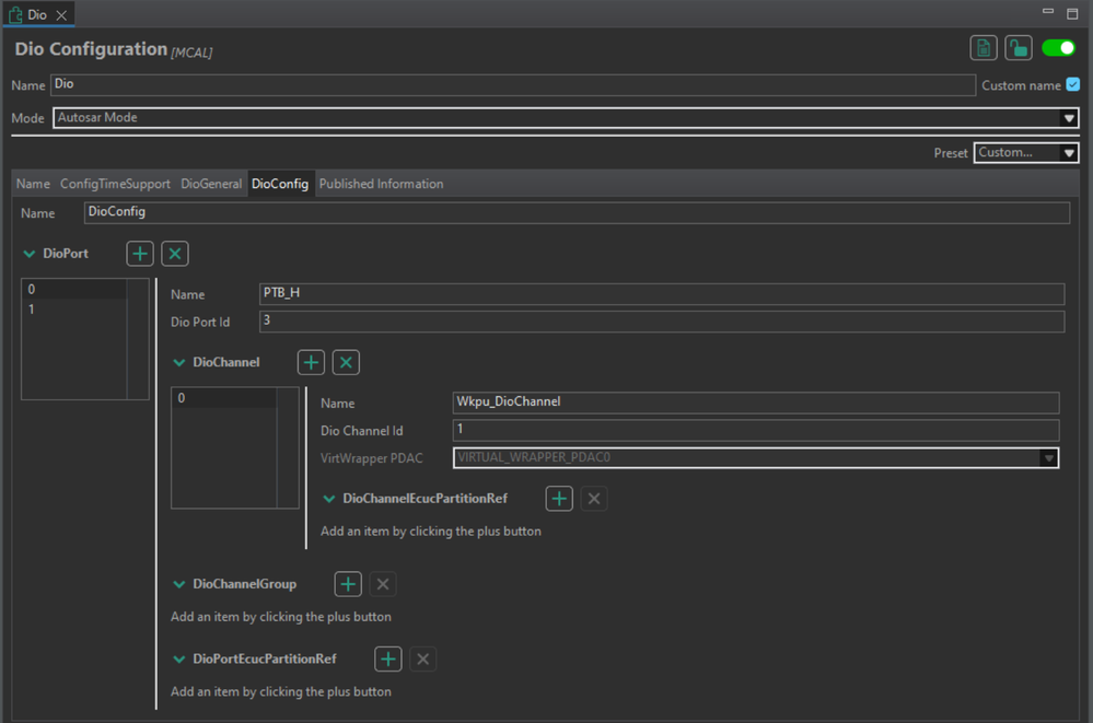

Dio component
Figure 3. Configuration Dio Component - DioGeneral
Figure 4.  Configuration Dio Component - DioChannel Wkpu_DioChannel
Figure 5.  Configuration Dio Component - DioChannel Green_Led_DioChannel

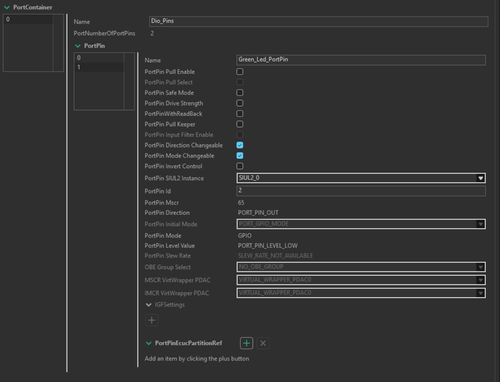

Port configuration
The Port configuration must match the settings configured in the Pins tab (check Pins Configuration chapter).
Figure 6. Configuration Port component - PortPin Wkpu_PortPin
Figure 7. Configuration Port component - PortPin Green_Led_PortPin

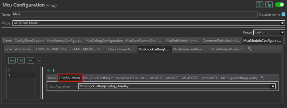

A new McuClockSettingConfig must be created. The MCU will use to this clock tree when it is in standby. All the settings in this newly created McuClockSettingConfig must match the settings made in Clocks tab.
Figure 9. Configuration Mcu component - McuModuleConfiguration -> McuClockSettingsConfig
Make sure that for the new McuClockSettingsConfig, in the configuration tab, the Functional Group created in Figure 2 is selected.
Figure 10. Configuration Mcu component - McuModuleConfiguration -> McuClockSettingsConfig -> Configuration

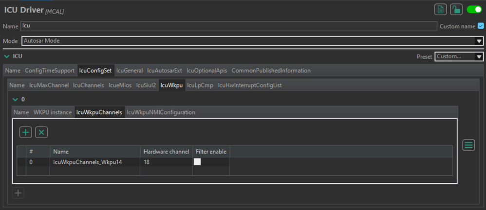

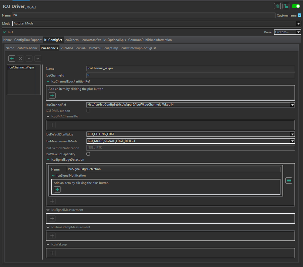

ICU configuration
Figure 11. Configuration Icu component - IcuConfigSet -> IcuChannels
Note! The first 4 Hardware Channel are internally routed. For the evaluation board that I used, the PTB17 corresponds to the WAKE_14. In the configuration project, the hardware channel must be set to CH18 (to offset the first 4 internally routed hardware channel).
Figure 12. Offset internally routed hardware channels
Figure 13. Configuration Icu component - IcuConfigSet -> IcuWkpu -> IcuWkpuChannels

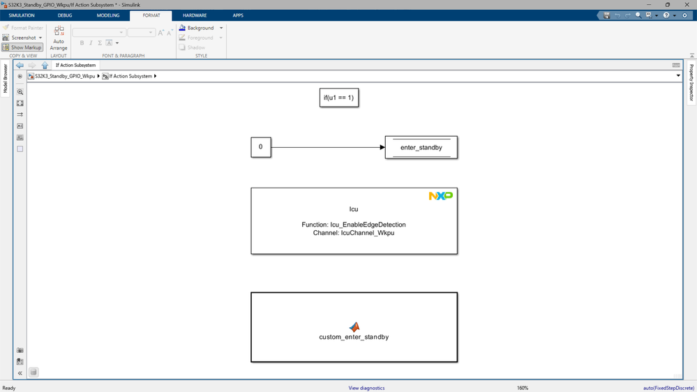

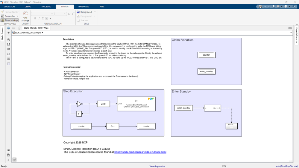

Model configuration
The Simulink model used to switch from RUN mode to STANDBY mode can be seen in the picture below. It can also be found in the achieve attached to this article.
The application executes the following tasks at each steps:
  • Toggle the LED to visually tell if the board is running or in standby mode
  • Increment a variable
  • Check if the enter_standby variable is set to 1. If true, the sequence to enter standby mode is executed.
Figure 15. Simulink Model S32K3_Standby_GPIO_Wkpu

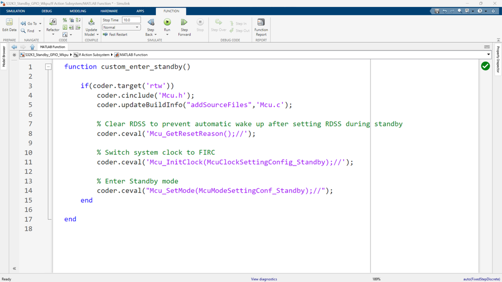

Figure 16. Enter Standby mode routine
Figure 17. Custom code to enter standby mode
Validation
To validate the application, the FreeMASTER tool is used to connect to the board and initiate the sequence to enter standby mode. To connect the board, I used the debug probe.
Figure 18. Connect FreeMASTER tool to the board using debug probe
If everything is properly configured, the FreeMASTER should now be connected to the board. In the Variable Watch, the value of the counter variable is increased each second.
To enter standby mode, the value of the enter_standby variable must be set to 1. If the sequence to enter standby mode is correctly executed, the value of the counter shouldn't be updated anymore and the LED should stop blinking. Also, the board is disconnected from the FreeMASTER board.
To exit standby mode, use the jumper wire to connect the PTB17 to a GND pin. The LED should start blinking.
