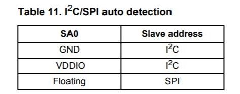

Unfortunately I don't have an fxls8471q for now, so I can't replicate your problem. But I took a look at what you described and you are right - after sending 0x0D,0x00,0x00 (requesting a read from WHOAM_I register) you should be getting something on MISO (like 0xFF,0xFF,0xNN - value of that register). This might be a problem with the mode auto detection (i2c/spi).
As you know, when you want to use SPI interface mode, you must ensure that SA0/MISO pin is floating and no other device drives this pin during the 1ms period after a hard/soft reset or powerup event. But there is one more catch - according to the errata found here , following a soft-reset command certain parameters do not get updated correctly from NVM, causing inaccurate data output and incorrect WHO_AM_I register content. This is a known issue with the SPI mode (I2C should work properly). Unfortunately for you, the workaround for this is avoiding using a soft reset, and using a hardware reset instead.
You can try to soft-reset it by setting CTRL_REG2[rst] = 1, where rst is the 6th bit, but if this does not do the trick, you might have to change something in your setup so you can issue a hardware reset.
