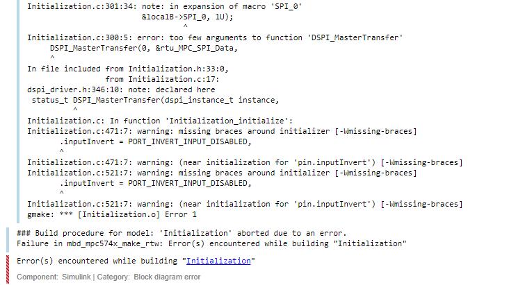

Dear All
I experienced an error while building a model to Initialize FET Prediver (33937A).
The build error seems to originate while using SPI Block.
I have attached the error (MATLAB Diagnostic) in txt file as well as the model.
Please let me know why this issue seems to be.
Abhishek
1,033 Views
constantinrazva
Hello abhishek.kumar@chassisbrakes.com‌,
I've found the problem:
In MPC5744.h, at line 17064, there is the following define
#define SPI_0                                    ((SPI_Type *)SPI_0_BASE)
At the same time, in the model you've sent me, the name of the SPI Master transfer block is SPI_0. A variable generated to be used as input/output for that block is named SPI_0, as MATLAB codegen has no idea that it should not use that exact name; it just puts the name of the block there. So this is what is actually going on.

Took a while to find the culprit, but the fix is simple - just rename the SPI Master transfer block from SPI_0 to something else (e.g: SPI_zero or SPI_00).

1,033 Views
abhishek_kumar1
Dear constantinrazvan.chivu
Works like a charm.
Abhishek

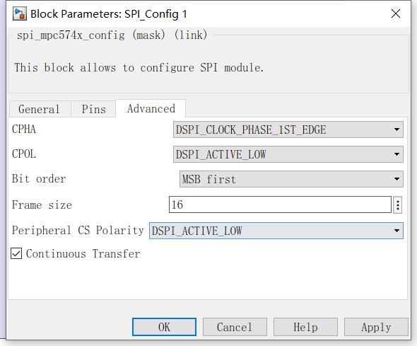

lijiantaowy
Hello Abhishek Kumar,
When I use the MPC57XX MBD toolbox to configure SPI and communicate with power chip, the data structure required by the power chip is 16-bit, as shown in the figure below, but only the 8-bit data transmission can be configured in the toolbox. Is there any way to solve it?
