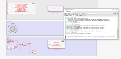

I don however get an error whist trying to change the value in the example model:
This is after I changed the constant block from inf to -1 sample time as that was also causing an error.

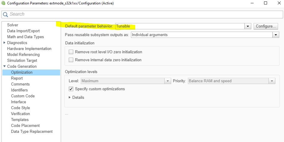

mariuslucianand
Hello @Poley
You have to go to Default parameter behavior to Tunable
Additional settings that you can make can be to change the solver to "auto" you can decrease the sample time, which is now 0.1 to 0.001 to see some results on the led and to check the "Automatically handle rate transition for data transfer".
In addition, I've added a PWM signal to the Green LED.
Hope this helps,
Marius

Poley
Contributor V
Ah perfect, thank you!
