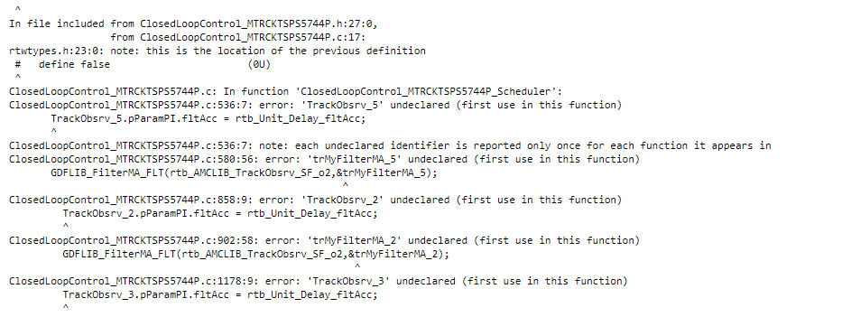

Dear All
We are facing an issue while building a project while using "AMCLIB_TrackObsrv_FLT" and "GDFLIB_FilterMA_FLT". The Toolbox is for MPC57xx and the micro-controller used is MPC5744P with Matlab 2018b being used.
This is a very surprising error while compilation. (below)
The error is attached in a text file with the model

abhishek_kumar1
Hello
I found the issue. It was path deceleration in Matlab. The libraries 2 different paths stored in MATLAB. I cleaned the add path and works correctly now.

abhishek_kumar1
Hello
