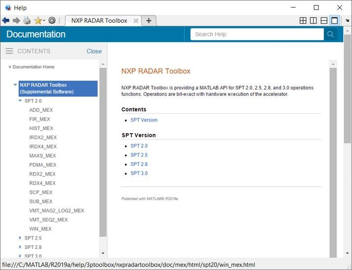

  • Integrate Help and Examples into MATLAB documentation framework. Opening the MATLAB Help will show new section of “Supplemental Software” for Model-Based Design for SPT Toolbox.

Our customers used SPT2.0 with NXP_RADAR_TOOLBOX1.2.0 to run SPT_Example.m normally, but after upgrading to NXP_RADAR_TOOLBOX1.3.0, some errors occurred. Please help to check the reason.
The picture is as follows:
SPT2.0+NXP_RADAR_TOOLBOX1.2.0  is OK
SPT2.0+NXP_RADAR_TOOLBOX1.3.0 have some issues.

Hello nxf47389‌,
You should uninstall the toolbox SPT_2.0_64-bit. This is one of the earliest version of NXP_RADAR_Toolbox_for_S32R.
The error is because there was added a new argument to the following mex files: rdx2_mex, rdx4_mex, irdx2_mex, and irdx4_mex.
syntax for SPT 2.x
[M_Out, adptv_acc_shift] = rdx2_mex(M_Tw, M_Op, fft_rnd, real_fft, quad_ext, repeat, shft_val, adptv)
[M_Out, adptv_acc_shift] = rdx4_mex(M_Wc_Tw, M_Op, win_type, win_coeff_type, fft_rnd, quad_ext, repeat, shft_val, adptv)
[M_Out, adptv_acc_shift] = irdx2_mex(M_Tw, M_Op, fft_rnd, quad_ext, repeat, shft_val, adptv)
[M_Out, adptv_acc_shift] = irdx4_mex(M_Wc_Tw, M_Op, win_type, win_coeff_type, fft_rnd, quad_ext, repeat, shft_val, adptv)
syntax for SPT 3.0
[M_Out, adptv_acc_shift] = rdx2_mex(M_Tw, M_Op, fft_rnd, real_fft, quad_ext, shft_val, adptv)
[M_Out, adptv_acc_shift] = rdx4_mex(M_Wc_Tw, M_Op, win_type, win_coeff_type, fft_rnd, quad_ext, shft_val, adptv)
[M_Out, adptv_acc_shift] = irdx2_mex(M_Tw, M_Op, fft_rnd, quad_ext, shft_val, adptv)
[M_Out, adptv_acc_shift] = irdx4_mex(M_Wc_Tw, M_Op, win_type, win_coeff_type, fft_rnd, quad_ext, shft_val, adptv)
adptv_acc_shift is the adaptive scaling accumulated shift
adptv is the adaptive scaling type; valid values are:
  • 'NO_ADPTV' - disable adaptive scaling
  • 'ADPTV_TYPE1' - MSB occupation counter counts unoccupied bits from bit 15 downwards
  • 'ADPTV_TYPE2' - MSB occupation counter counts unoccupied bits from bit:
    • 23 downwards for SPT 2.0, 2.8 and 3.0
    • 19 downwards for SPT 2.5
