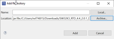

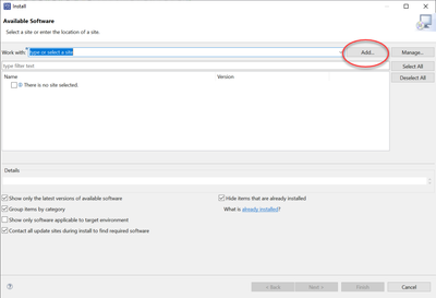

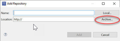

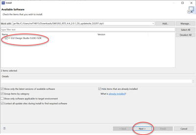

Senlent
Hi@Ganesh_Pawar
I am sorry that the installation problem has troubled you, I have summarized my installation process, you can refer to it.
1.download highlight parts.
2.open S32 DS V3.5 ->Help->Install New Software,
After the installation is complete, restart S32 DS V3.5, and you should be able to use it.
If you still have problems related to install this software, please contact me in time, and I will help you solve them in time.

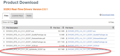

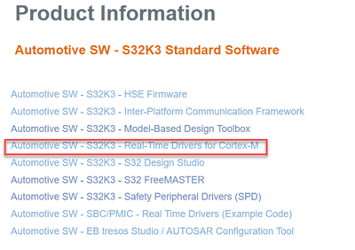

Senlent
Hi@Ganesh_Pawar
first, you need  to sign on NXP webpage.
1.then:
https://nxp.flexnetoperations.com/control/frse/product?entitlementId=599328327&lineNum=1&authContact...
2.
3. S32K3 Real Time Drivers Version 2.0.0

9,567 Views
Senlent
Hi@Ganesh_Pawar
9,557 Views
Ganesh_Pawar
Hi @Senlent ,
Greetings for the day...!!!
               Thank you very much for your time and guidance really appreciate it, I have the SDK file as per your installation guide really helped me to get it .
