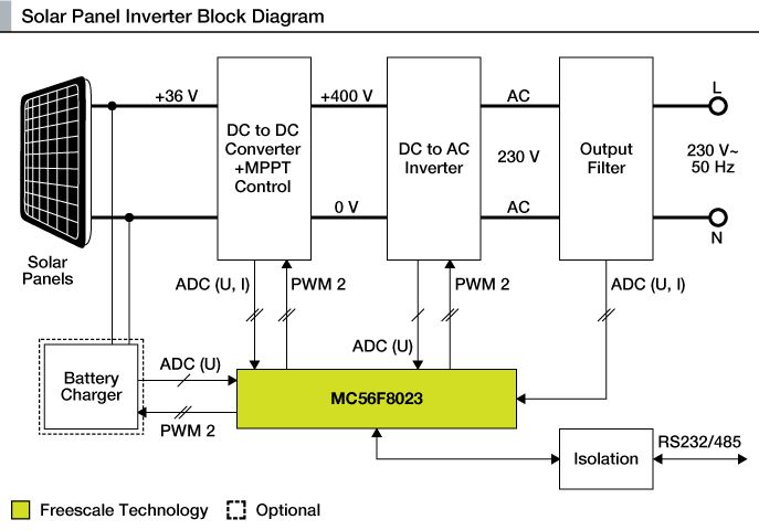

Overview
The NXP® Solar Panel Inverter reference design demonstrates the ability of the 16-bit digital signal controller MC56F8023 to control whole inverter functionality.
  • The inverter converts the input voltage from the solar panel to isolated one-phase AC output voltage
  • The application comprises all needed circuitry for power transfer, control and measurement
  • The main power board provides standard 64-pin PCI Express® connector as the interface for the daughter card control board, providing the ability to control this inverter by other digital signal controllers
Features
  • DC input voltage from the solar panel in the nominal level of 36V
  • Possible to use one 36V or two 18V solar panels in series connection
  • Maximum power point tracking feature in the control software implemented
  • Battery charger for the 3 x 12V lead-acid accumulators in series included
  • Galvanic isolated output voltage 230V 50Hz up to 400W output power
  • True sine shape output voltage
  • RS-485 isolated interface for the external communication
  • Internal low-power DC power supply maintains proper functionality without battery connection
  • Overvoltage, overcurrent and overtemperature protection implemented
  • Embedded software example for off-grid available
Block Diagram
