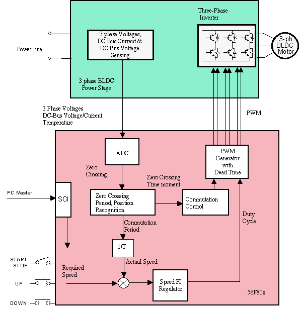

This reference design describes the design of a 3-phase sensorless brushless DC (BLDC) motor control with back-EMF (electromotive force) zero-crossing sensing using an AD converter for the NXP® 56F80X and 56F83XX Digital Signal Controller (DSCs) dedicated for motor control applications.
  • It can also be adapted to Our 56F81XX Digital Signal Controllers
  • The system is designed as a motor drive for three-phase BLDC motors and is targeted for applications in both industrial and appliance fields (e.g. compressors, air conditioning units, pumps or simple industrial drives)
  • The reference design incorporates both hardware and software parts of the system including hardware schematic
Features
  • BLDC sensorless motor
  • 115 or 230V AC Supply
  • Targeted for 56F80x, 56F83XX, and 56F81XX Digital Signal Controllers
  • Running on 3-phase BLDC Motor EVM at 12V, 3-Phase BLDC Low-Voltage Power Stage
  • Speed control loop
  • Motor mode in both direction of rotation
  • Manual interface (RUN/STOP switch, UP/DOWN push buttons control, LED indication)
  • Overvoltage, undervoltage, overcurrent and overheating fault protection
  • PC remote control interface (speed set-up)
  • FreeMASTER software remote monitor
Block Diagram
