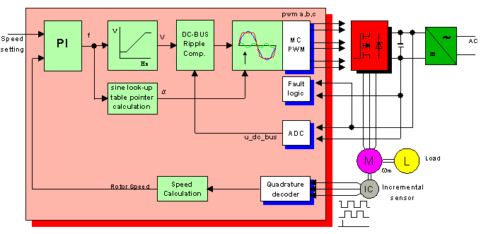

This reference design demonstrates the design of a 3-phase AC induction motor drive with volt per hertz control and supports the NXP® 56F80X and 56F83XX Digital Signal Controllers (DSCs) dedicated for motor control applications.
  • Designed as a low-cost high volume motor drive system for medium power three-phase AC induction motors and is targeted for applications in both industrial and appliance fields
  • The drive runs in a speed closed loop using a speed sensor
  • According to the state of the control signals (Start/Stop switch, speed up/down buttons or PCMaster set speed) the speed command is calculated using an acceleration/deceleration ramp
Features
  • Speed Control of 3-phase AC Induction motor with quadrature volt per hertz control
  • Targeted for 56F80X, 56F83XX, and 56F81XX Digital Signal Controllers
  • Running on a High Voltage Medium Power Board for Three Phase Motors
  • Volt-per-Hertz control with a speed closed loop
  • Option to run the motor in open loop
  • Quadrature encoder for motor speed reference
  • Manual interface
  • PC master software control interface and monitor
  • Fault protection
Block Diagram

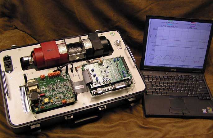

Board
