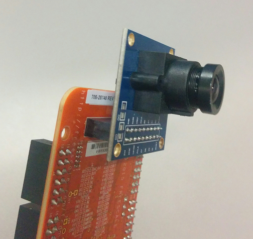

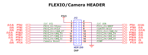

One of the new features that can be found on the FRDM-K82F is the FlexIO header. It’s be specifically designed to interface with the very cost-efficient OV7670 camera, and uses 8 FlexIO lines to read data from the camera. By using the FlexIO feature, it makes it easy to connect a camera to a Kinetis MCU. A demo is included with Kinetis SDK 1.3 which streams the video data from the camera to a host computer over USB
