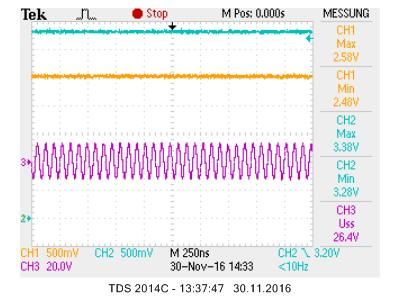

jensboettcher
hello kan,
no, theres no changing in the supply voltage measurable. i try to find out if a brown-out is happen. the microcontroller has two supply voltages, one for the core and one for the periphery. when the core voltage fall under a range of 1.9 ... 2.2 V a brown out is triggered. when i trigger on a falling edge on a voltage level of 2.3 V this event never happend, only when i put off the hole supply voltage. the same i try with the 3.3 V supply for the periphery with a trigger on 3.2 V, but no event too.
even with the field on, theres no ripple shown on the supply. the blue one (CH2) is the peripheral supply (3.3 V), the yellow (CH1) is the core supply (2.5 V) and the violett (CH3) is the measured field of the antenna. the gnd is measured on the gnd-area of the microcontroller and the supply voltages are measured as close as possible to the microcontroller pins. this measuring is from the test setup.
i found no suspicious condition near the microcontroller in the supply voltage.
i found out that the reset not so often occurs when the microcontroller only search for ISO15693 TAGs. but in this situation a random reset can provoke when i spin or wobble the TAG in the electromagnetic field (per hand). when i lie the TAG on a cardboard over the antenna no reset occurs and the UID of the TAG can read out without problems.
