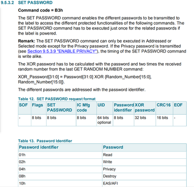

first get random
detal:
send 09 00 22 b2 04 + UID
rev 00 xx xx(randdom number)
xx Rand[0] Rand[2]
xx Rand[1] Rand[3]
then XOR_password
detal:password 0000 0000(original password)
In the end! Set read password
send 09 00 22 b3 04 +UID +01(read type) +XOR_password
rev 01 0f
Final reply error.
Are my steps correct?

Hi @guangshi ,
Hope you are doing great the process for this should be :
  1. activate the ICODE by sending the inventory command
  2. select the ICODE you want with the select command
  3. get random number
  4. set password, for the PWD ID you want to use:
    • 01- Read
    • 02 - Write
    • 04 - privacy
    • 08 - Destroy
    • 10 EAS/AFI
you can find a script I just did for you doing the above process for the ICODE SLIX2 and Read PWD.

* The SET PASSWORD command enables the different passwords to be transmitted to the label
* to access the different protected functionalities of the following commands.
* The SET PASSWORD command has to be executed just once for the related passwords if the label is powered
ISO15693ErrorCode PN5180ISO15693::setPassword(uint8_t *password, uint8_t *random) {
uint8_t setPassword[] = {0x02, 0xB3, 0x04, 0x04, 0x00, 0x00, 0x00, 0x00};
uint8_t *readBuffer;
setPassword[4] = password[0] ^ random[0];
setPassword[5] = password[1] ^ random[1];
setPassword[6] = password[2] ^ random[0];
setPassword[7] = password[3] ^ random[1];
ISO15693ErrorCode rc = issueISO15693Command(setPassword, sizeof(setPassword), &readBuffer);
return rc;
ISO15693ErrorCode PN5180ISO15693::enablePrivacy(uint8_t *password, uint8_t *random) {
uint8_t setPrivacy[] = {0x02, 0xBA, 0x04, 0x00, 0x00, 0x00, 0x00, 0x00, 0x00};
setPrivacy[3] = password[0] ^ random[0];
setPrivacy[4] = password[1] ^ random[1];
setPrivacy[5] = password[2] ^ random[0];
setPrivacy[6] = password[3] ^ random[1];
ISO15693ErrorCode rc = issueISO15693Command(setPrivacy, sizeof(setPrivacy), &readBuffer);
return rc;
