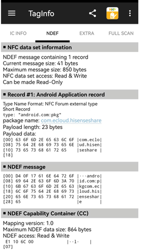

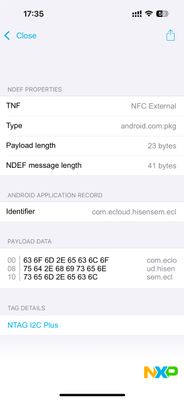

Operation Steps:
  1. Install the TagWrite application and the TagInfo application on an Android phone, and install the TagInfo application on an iPhone.
  2. Write NDEF data through the TagWrite application: (in the "launch app" type), with the package name: com.ecloud.hisenseshare.
  3. Open the TagInfo application on both the iPhone and the Android phone to read the package name.
android phone:
iphone:
 what the reason is for the different display of this package name?
