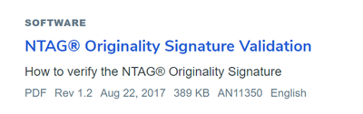

I have a question about originality check on NTAG213 chip using IPhone.
Is it possible to perform an originality check using the NXP application on IOS? In the way that is this done on an Android app? (after reading the tag, there is information about checking the authenticity of the tag).
Is it possible to store the public key with an iPhone and check the authenticity of the chip with this device? Is it possible to create this type of application for IOS?
Thank in advance for help!

Hi @Mateusz_Chamera ,
Indeed this app note is just regarding the implementation, and includes sample code in Java and C , but there is no Android/iOS App for refence,  you have to implement it by yourself.
BTW, there is a demo on this topic based on Visual Studio, please kindly refer to the following for more details.
https://community.nxp.com/t5/NFC-Knowledge-Base/Demo-for-Originality-Signature-Verification/ta-p/127...
Hope that helps,
Kan

Kan_Li
Yes, it is possible to perform an originality check using the NXP application on IOS as well as on an Android app. (after reading the tag, there is information about checking the authenticity of the tag).
It is also possible to store the public key with an iPhone and check the authenticity of the chip with this device.
Please kindly refer to the following app note for more details.
Hope that helps,
Kan

Mateusz_Chamera
Hi @Kan_Li ,
I have this document, but there is not a word (and no example) about iOS in it.
I also haven't found any application in the AppStore that would allow me to perform an originality check. The NXP Tag Info app for iOS does not show this information (unlike on Android devices).
Therefore, I would like to make sure (or see an example) of reading the private key from NTAG213 memory using the iPhone.
Are there any examples of such an application?

Kan_Li
Hope that helps,
Kan

Hello @Kan_Li ,
Of course, I understand that application development is on my side. Thank you for the answer, I think I have already confirmed what I am looking for.
My main question was whether the iPhone is able to obtain the private key from the NTAG213 chip memory and verify its authenticity on this basis. If it is possible on iOS, I got a satisfactory answer.
Thank you for the demo as well.
