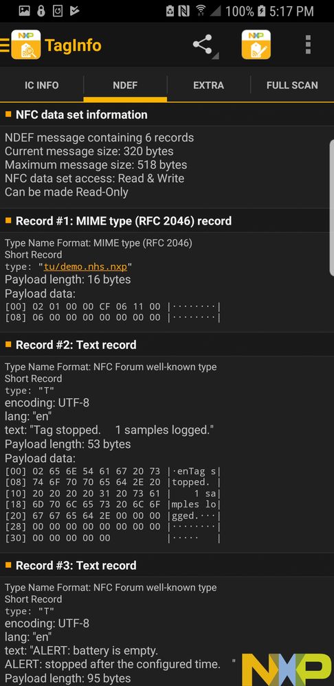

ashtri008
Hi Dries,
It is just as you said we are doing the same by sending the configuration of the card and it also shows the measurement has started message but it always shows us the same information, which is only one logged value since january and measurement has stopped after timeout exception it doesn't seem to log anything further.Is something wrong with the card?

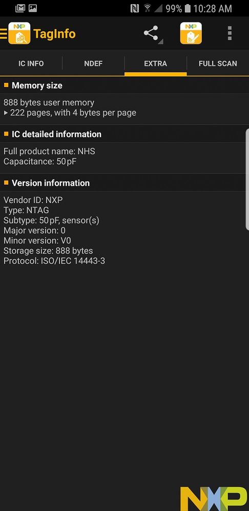

driesmoors
Thanks.
Can you also provide the contents of the "NDEF" and the "FULL SCAN" tabs?
Dries.

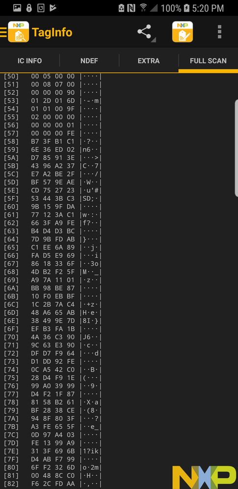

ashtri008
Hi Dries,
Please Find the other Screenshots related to the tag info as an attachment with this mail.

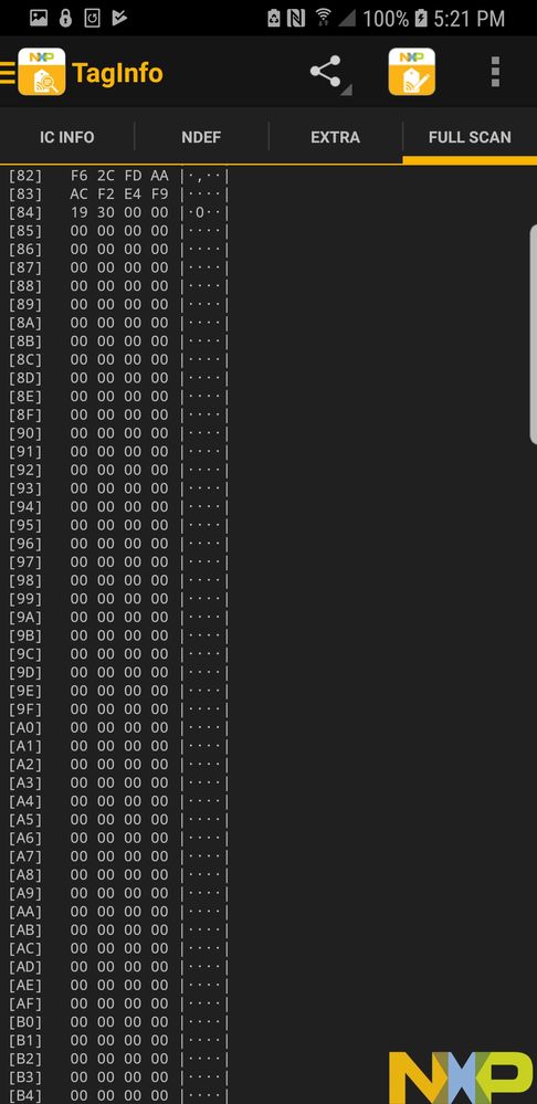

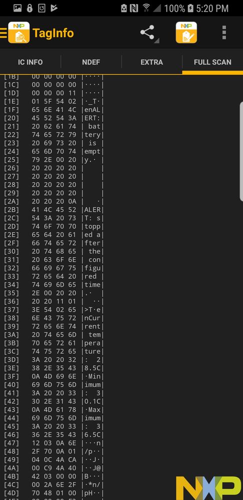

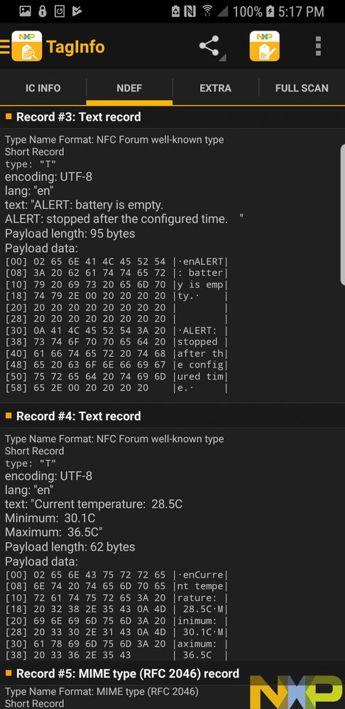

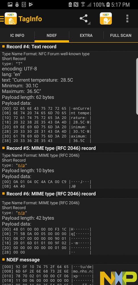

driesmoors
Thank you for the screenshots.
I see two alerts:
ALERT: battery is empty.
ALERT: stopped after the configured time
This corresponds to the status field in the MIME record starting with
48 01 ...
It seems that the battery is empty. Can you replace it and try again?
Kind regards,
Dries.

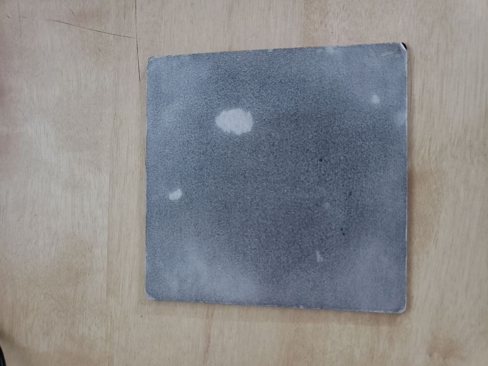

ashtri008
 Hi Dries,
 Thank you for the reply.
 According to our understanding, NFC tags/chips are passive in nature and are charged by induction so they don't need external charging.
 Does that mean its battery is completely failed and need to replace?
 If this is the case then please guide us how this would be done in this tag (Please see the frontsideNFCtag.jpgbacksideNFCtag.jpgattached pic)?
Thanks.
