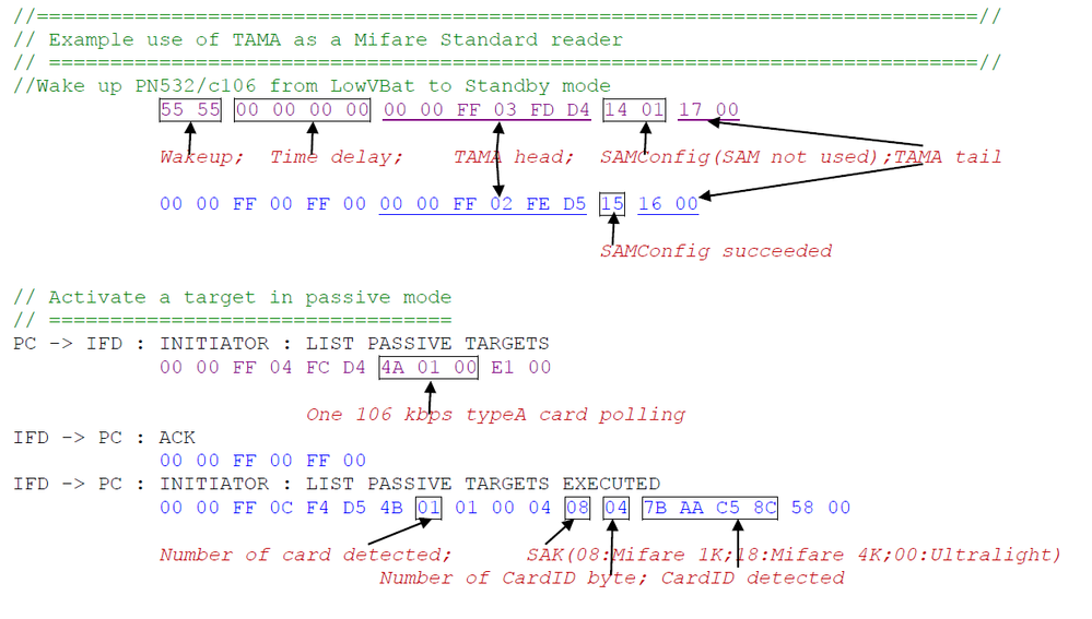

Could anyone give me an example demo of PN532 with i2c?Thanks!

Hi Yanzhou,
I have the example for PN532 as a Mifare Reader, please refer to the following for details.
Hope that helps,
