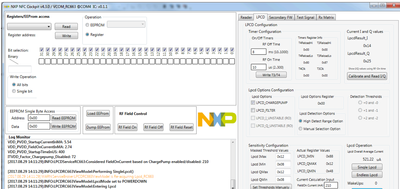

Fabian_R
Hello sir,
In order to calibrate the CLRC663 for LPCD, we highly recommend to please use NFC Cockpit.
This is a GUI tool that allows the user to graphically fine-tune the antenna along with LPCD calibration (Section 4.5) . We encourage you to please use this method since the calibration has to be done depending of your own design. There is no manual to do this procedure in a step-by-step manner.
NFC Cockpit allows the user to calibrate, while the reader is unloaded and then, loaded in real time.
Please explore the possibility of checking the 4th video for the following antenna design video series: NFC Antenna Design | NXP Semiconductors
Fabian
