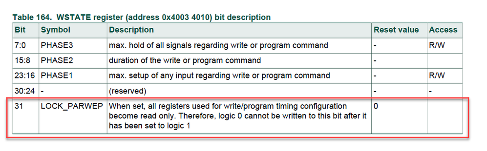

Hi Steve,
Would you please specify how you set the tags to configuration lock state? Did you set this bit as below?
Please kindly clarify.
Thanks for your patience!
Kan

I will describe these changes because I am not sure exactly what the SDK does to store the locking state – but it goes into ‘memory’ with the rest of the logging configuration status. We believe that ‘memory’ in this case is EEPROM, but would like that confirmed. Our clue is that Memory_Init() and Memory_DeInit() call Chip_EEPROM_* functions with the EEPROM_OFFSET_CONFIG parameter. We do not believe this is related to your reference to Table 164. WSTATE register, bit 31, LOCK_PARWEP.
