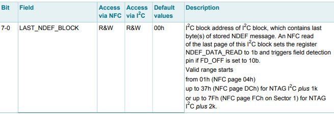

LAST_NDEF_BLOCK works as “monitor” which can be set to monitor a change of value in chosen UserMemory block. When value in that block changes, ED (interrupt) is fired. E.g. This can notify µC that it can start accessing eeprom.

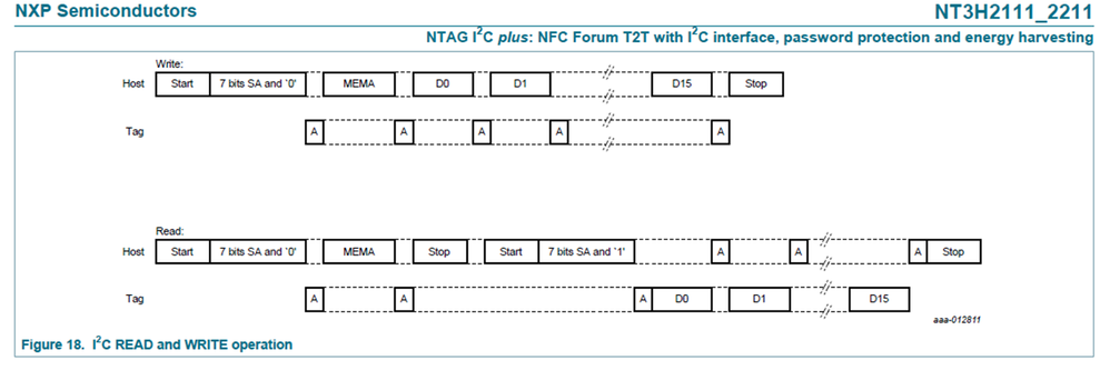

User Memory can always be read by I²C if I2C_PROT is not 1b. Beware to use proper command formatting on i²C which differs from register access formatting, described on page 44 of Datasheet:
Please could you explain how this is done, both from I2C perspective and NFC perspective. I had somehow assumed that this was automatic and I did not realise it can be used to monitor a chosen UserMemory block, which is quite useful.
1,201 Views
Jonathan_Iglesias
Please check the DS
there is an explanation of it in table 13. please check it.
