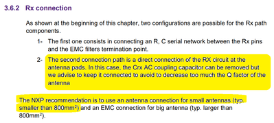

I think I have got something, firstly after carefully checking the antenna and reading the information in document AN11755, in section 3.6.2 it is mentioned about the connection of RX terminals.
In my case, the dimensions of the antenna are 15.5 mm wide by 27.51 mm, that is, an area of 426.41 square mm.
For such a surface, the document recommendation indicates that the RX terminals should be connected directly to the antenna.
So I made this correction to the antenna (removing Rrx and Crx and directly connecting the RX terminals to the antenna)
In this way, the error was no longer displayed immediately after Start Discovery.

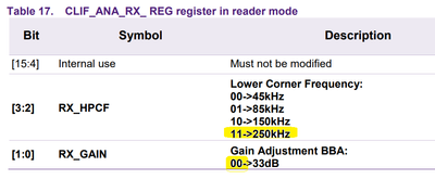

I vaguely understood that possibly my error is corrected by modifying the CLIF_ANA_RX_REG registry (section 5.5.3.1).
After doing some tests, I decided to modify the register for a gain of 0 dB and a corner frequency of 250 kHz.
That is to say that I modified RF_CLIF_CFG_BR_106_I_RXA_P as follows:
//0xA0, 0x0D, 0x04, 0x34, 0x44, 0x22, 0x00,/* RF_CLIF_CFG_BR_106_I_RXA_P   CLIF_ANA_RX_REG */
0xA0, 0x0D, 0x04, 0x34, 0x44, 0x2C, 0x00,/* RF_CLIF_CFG_BR_106_I_RXA_P   CLIF_ANA_RX_REG */
