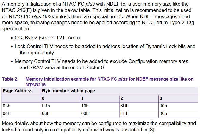

Did anyone find out the proper NTAG I2C plus (2k version) memory configuration TLVs? I have submitted a request to my rep to push this doc to me via docstore since I could not find it natively (docstore search function is atrocious). My primary question centers around the "Memory Control TLV" that is supposed to be written to the last blocks of "Sector 0" which I assume is the first 888 bytes of user data before the configuration pages hit. This TLV is supposed to instruct the NDEF library performing the writing to jump over or skip the configuration pages and jump all the way to page 100 to continue writing data.. I just need confirmation on what that TLV looks like and where to put it.
This is a screencap from AN11786 with the pertinent info; http://amal.net/caps/2019-11-08_12-05-09-firefox.png
Anyone with this info, please just share the appropriate blocks and values to enable safe normal NDEF writing?
