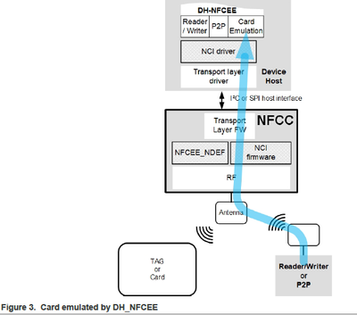

In the libnfc-nxp.conf file there is an NXP_T4T_NFCEE_ENABLE property.  I exclusively use the linux-nxp-nci library for reading tags (and not tag emulation).   It was originally set to 0x01, but I noticed setting this ENABLE flag to 0x00 does not affect anything.  What does it actually do?

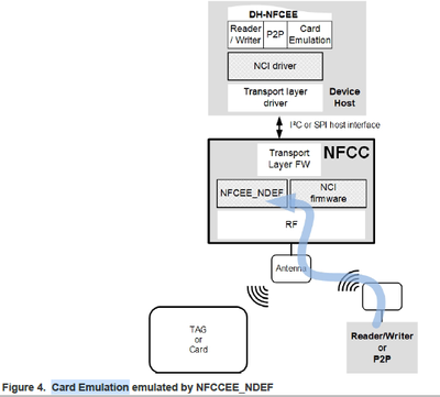

Please see below two pictures.  two implementation of card emulation.
scenario 1:  card emulation by DH_NFCEE, pn7160 is responsible for forwarding the communication from the external Reader/Writer to DH-NFCEE.
scenario 2:   Card Emulation over NFCC,  the card is emulated on the NFCC
To switch between scenario 1 and scenario 2, we use this flag NXP_T4T_NFCEE_ENABLE
If we want to use scenario 1 (card emulation by the DH-NFCEE): NXP_T4T_NFCEE_ENABLE = 0x00.
If we want to use scenario 2 (card emulation over NFCC): NXP_T4T_NFCEE_ENABLE = 0x01.
