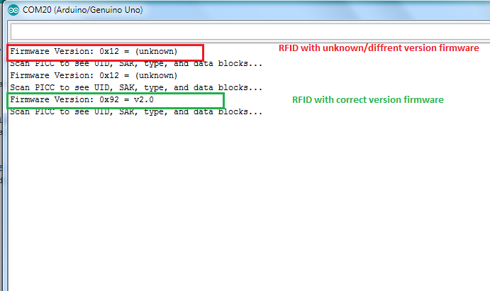

I bought 100 pieces of RFID reader from a vendor for cheap. Now I got to know it is not compatible with our code which works fine with RFID readers with firmware Version: 0x92 =v2.0.
The RFID reader I bought have firmware version 0x12=(unknown).
How can I update the firmware of my RFID card reader ? If it is possible then how can I do it ? what tools and software will I need to update the firmware on these RFID reader.  Please guide me NXP community.

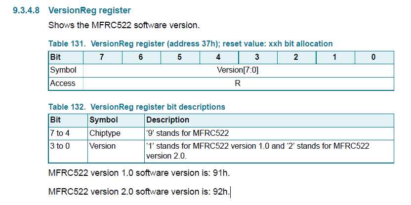

Hi Davinder,
Actually the correct version info is like below:
There is no 0x12 for version number, which vendor did you buy from? I guess it is a counterfeit.

Thank you for answering my question. Looks like I bought counterfeit RFID modules.
