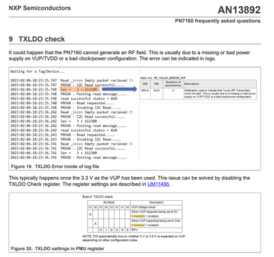

But when i bring ST25DV04KC tag near reader RF field, the discovery process is unable to discover the tag. We have also tried using other passive tags but still unable to get any discovery notification.
In NxpNci_WaitForDiscoveryNotification we get stuck at the following code snippet, the response we are receiving is 0x61 0x23 0x00 but it requires first 2nd byte to be 0x03.
    do
        if(NxpNci_WaitForReception(Answer, sizeof(Answer), &AnswerSize, TIMEOUT_INFINITE) == NXPNCI_ERROR) return NXPNCI_ERROR;
    }while ((Answer[0] != 0x61) || ((Answer[1] != 0x05) && (Answer[1] != 0x03)));
Below i have given the NCI Debug logs for referrence:

[18:03:36:797]
[18:03:36:808] WAITING FOR DEVICE DISCOVERY
[18:03:37:296] NCI << 61 23 00
[18:03:37:306] NCI << 61 23 00
[18:03:37:322] NCI << 61 23 00
So can anyone please help me with this issue  of unable to discover ISO15693 based NFC tags in RW mode.

Hello nikhilkomalan,
See our AN13892 document -> 9 TXLDO check. It looks like this issue:
Tomas
