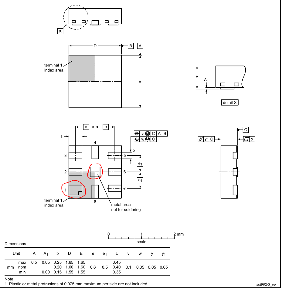

What is the package of this chip?
1, 1 PIN PIN package is special shape, but do not give the specific size.Is it the same size as other pins?
2. The size of the metal cooling pads in the middle area is not available.

Hello
In order to better service for you. Would you please provide the part number of the chip?
