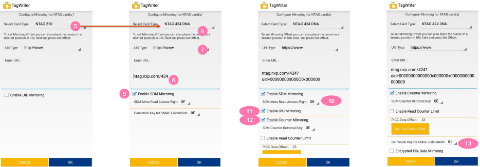

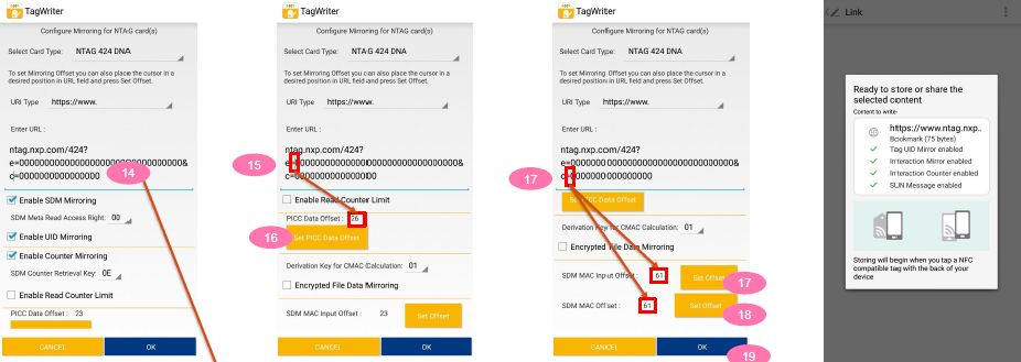

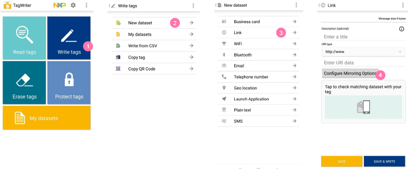

Jonathan_Iglesias
Hi Manuel Mertl,
Hope you are doing great,  I am not aware of a command line sw or something for this, usually customers have the option to use out Secure Services for the NTAG Product Family | NXP   where a customer can pay for the NTAGS already programmed with the information you need and with the keys and set up all of this is done in a secure environment, rather than a customer having someone using a non secure environment where  keys can be exposed,  but if you already have the tags the best would be that you use out tagwritter app for android devices,  you can program the tags with the SUN message and only use the tagxplorer app to modify the key values.
there is at the end the option to write multiple tags,  so you put one by one until you finish only you will need to do this  key change on other application like tagxplorer.  maybe this can help accelerate your process.  before doing the process from above I would recommend doing it on one tag to confirm the set up is correct then proceed to do it on all of your tags.
hope this helps. if you still have issues please let me know.
Have a nice day !
Jonathan
