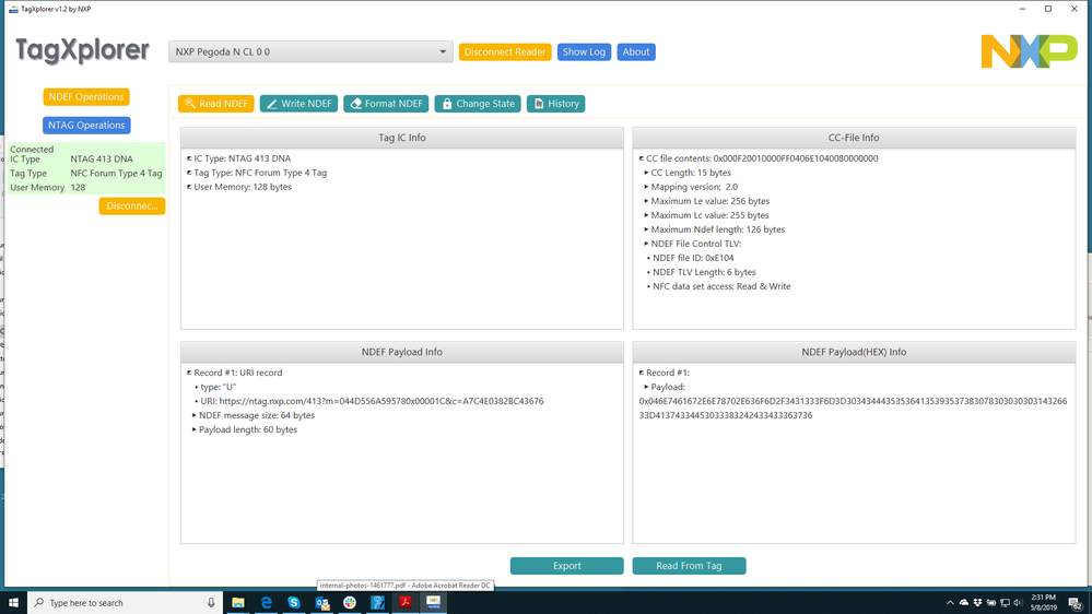

sjardot
Hello, good that you get the same result. But as you can see in https://community.nxp.com/message/1147548 , the NXP Pegoda (CLRD710) seems also not to be the problem, as it works with other tags. I also use the same firmware 2.2.8. on the Pegoda reader. Can you please check with the development team, what's the root cause and how to fix it via update of the tool?

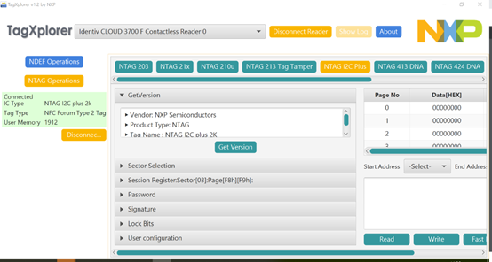

fangfang
Yes. I test it and get the same result with you. It should be  TagXplorer (v1.2) Application on Windows can't  match with a NXP Pegoda CLRD710 Reader. Thanks for your information.
And we recommend one use the TagXplorer (v1.2) Application on Windows with a Identiv cloud 3700F reader and a NTAG I2C Plus (NT3H2111W0FTTJ).
  Hope it help you. Have a nice day.
