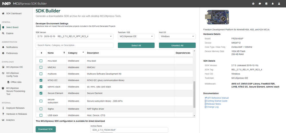

I'm supposed to develop software for the NTAG I2C plus (NT3H2111) which is connected to an STM32 F105. I haven't been able to find a library or even sample code for it. Does such things exist and could somebody point me in the right direction if the answer is yes?

Hope you are doing well. There is an example of the NTAG I2C (plus) available in the SDK. Please download from this page: SDK Builder.
There are some boards that include the examples in the middleware, for example if you download the FRDM-K64F SDK, you will find the NTAG I2C Middleware.

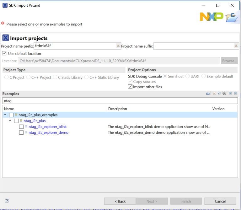

In MCUXpresso you will be able to import the ntag_i2c_plus examples.
