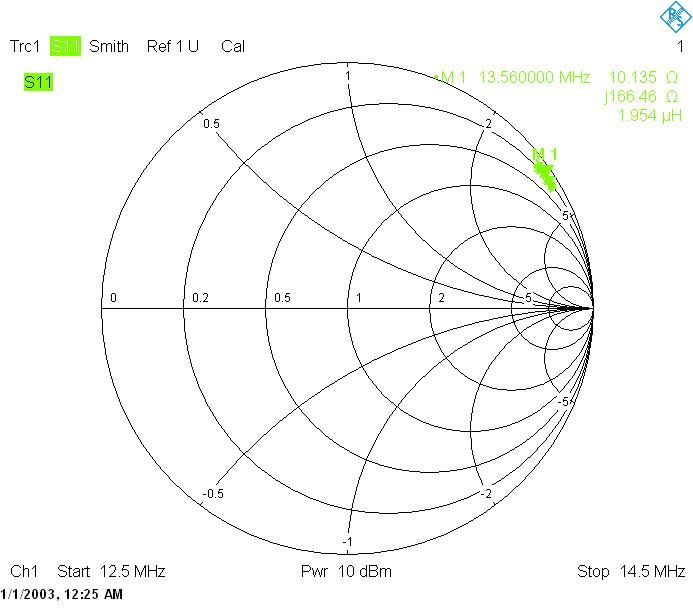

There is Problem with my measurement, In both measurements(Initial Coil measurement and TX1/TX2 measurement) my parameters was not stable,It changes and also my smith diagram is a bit different with document.I used same ZVB20 VNA and it was well calibrated. Does any one have any suggestion whats problem and how could I fix it ?
I attached my first measurement smith chart( from antenna coil leads) During measurement values changes from 3~11 ohm in real part.

My question is if PN5180 must be powered off during impedance measurement between TX1 and TX2 pins, then why we does not de-solder the inductor L1,L2 which removes, PN5180 output pins effect on our measurement ?
This disconnect antenna circuit from  from TX1 and TX2 pins which could change S11 parameter of antenna circuit.

The  impedance measurement between TX1 and TX2 pins should include PN5180 and it must be powered off.
