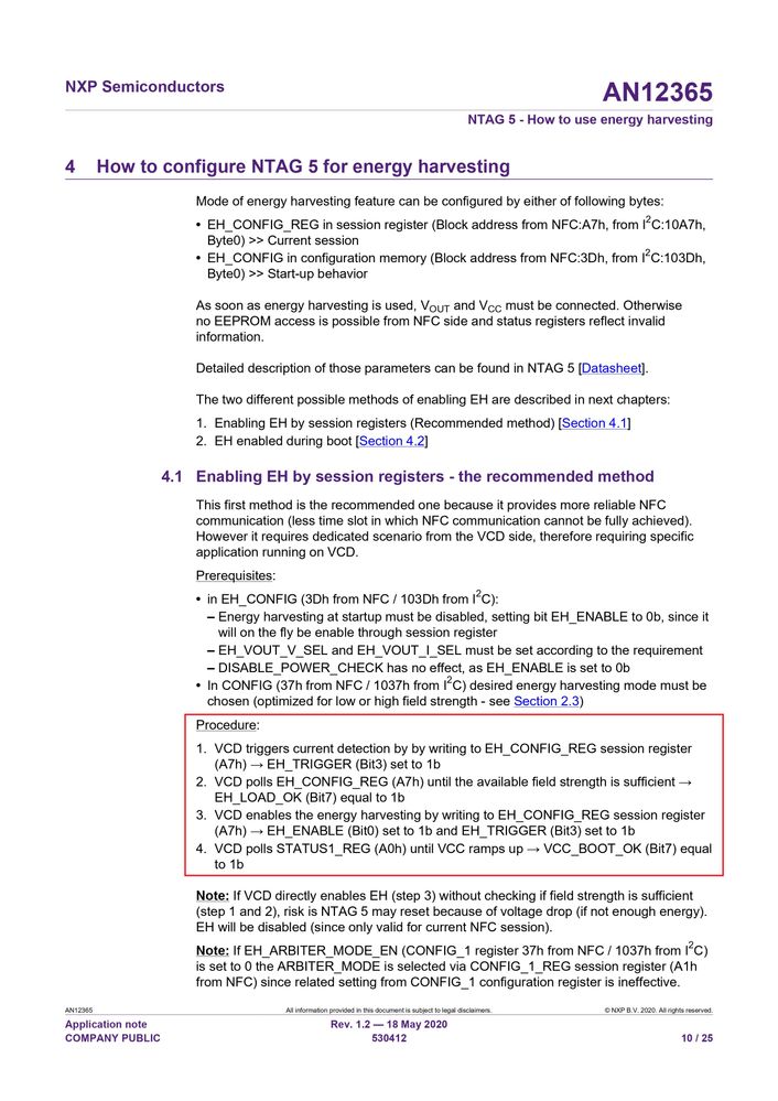

vince1
Eduardo,
I enable Energy Harvesting using session registers using the procedure in Section 4.1 of https://www.nxp.com/docs/en/application-note/AN12365.pdf?_gl=1*yitg9y*_ga*MTI1NjkyMTg2Ni4xNzE4MTM5Nz....
But the EH_CONFIG_REG session register does not change and there is no Energy Harvesting.
Do you have any suggestions?  Here are the Commands and Responses:
  1. VCD triggers current detection by by writing to EH_CONFIG_REG session register
(A7h) → EH_TRIGGER (Bit3) set to 1b

EduardoZamora
Could you please try enabling energy harvesting by following the procedure shown in NTAG 5 - How to use energy harvesting, Section 4.2?
After this, please let me know your findings.
Eduardo.

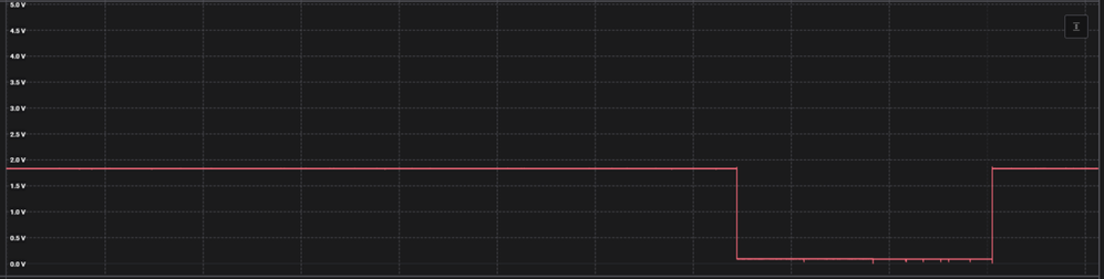

vince1
Eduardo,
Enabling Energy Harvesting during boot "using Configuration Registers" (Section 4.2 in AN12365) works!  See attached photos.
Enabling Energy Harvesting "using Session Registers" (Section 4.1 in AN12365) does not work, as described in my previous post).  The tag produces no EH.  This is where I need help.
Vince

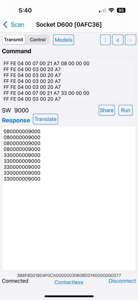

vince1
Eduardo,
Yes, I understand the Session Registers persist only for the current communciation session.   The EH_CONFIG_REG session register does not change (during the communication session) and there is no Energy Harvesting.
Do you have a working EH example using session registers to share?

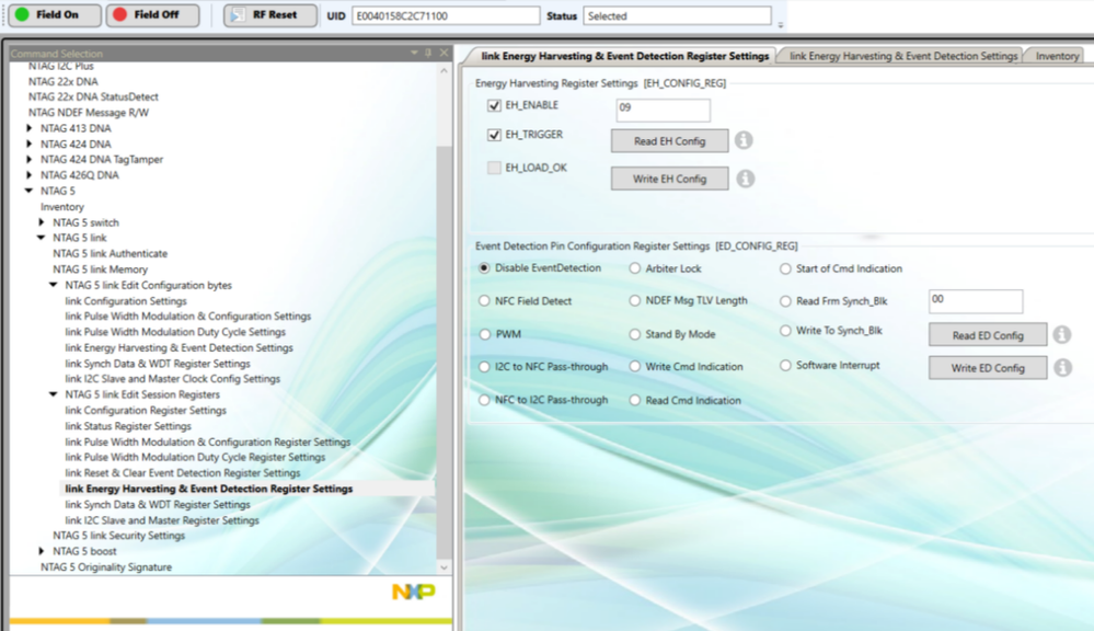

EduardoZamora
I tested the procedure by using session registers method as described in NTAG 5 - How to use energy harvesting, Section 4.1, PEGODA Reader and RFIDDiscover, and it is working as expected:
Eduardo.
23,378件の閲覧回数
vince1
Eduardo.
Thanks!  I reproduced your results using RFIDDiscover v5.5.0.0 / Pegoda 3.  I have some debug on my PoC to do.
